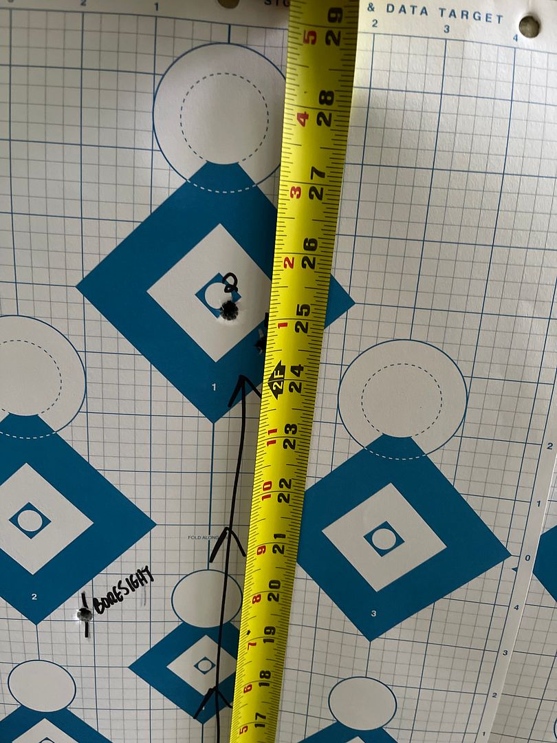

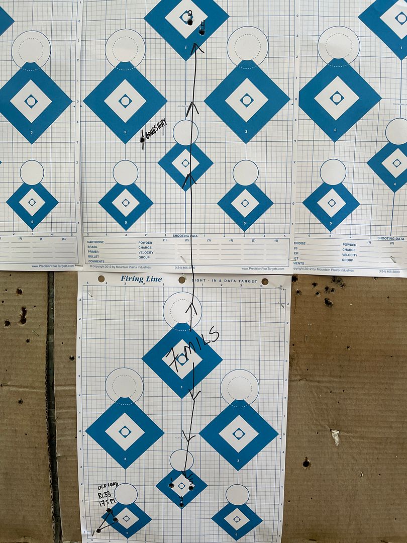

I just put a new scope on my 7 Mashburn. Decided to check it out a little.
I didn’t plumb bob it so I can’t say I’m perfect vertical yet but I decided measure it out and see if it worked as advertised. I had 5 rounds of old stuff for the gun left over. They don’t shoot bug holes like the load I just set up but they’re about an 1.25” sorta load in this new chamber.
I laid the reticle on my target and saw I could get about 7 mils out of it on paper so that’s what I used.
I fired 1 at the bottom, cranked 7 mils, shot another, back down for 3, back up for 4 and then back down for 5.
I figured out it should be about 25.06” between groups
So, while not a perfect test it wasn’t all over the map and when I laid the reticle back over the groups it looked spot on.
7 mils is out past a 1000 for me so it’s unlikely I’d ever use more hunting but I guess if I can get a taller target I’ll try it out. With the more accurate load I think it’ll look better on paper but for my purposes I have some trust the scope is doing as it is told.
Just figured this is a good spot for it. Jim spurred me to show what I do. I was just hurrying a bit and didn’t use a plumb bob for a straight line. Next time.
