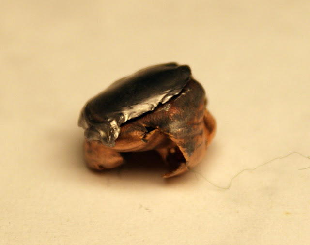

Here is a video from today. I ran the 250 Speer HotCor (35 Whelen), 130 NBT (.270), 130 NAB (.270) and 154 SST (.280) into water jugs. All bullets were recovered. The Whelen definitely owned the show. There is no footage of the 154 SST on the video. The camera guy (that would be me) screwed up on that one. I'll post the results up separately in the appropriate "bullet test" categories when I get a chance.
http://www.youtube.com/watch?v=sHO6QYSWQvE&feature=youtube_gdata
Here are the jugs loaded up, ready to go:
Here are the numbers and bullet pics:
130 NBT @ 3250 fps: 62.9 gr retained (48.4 %), expanded to .777", recovered in 3rd jug.
130 NAB @3200 fps: 84.6 gr retained (65.1%), expanded to .654", recovered in 4th jug.
154 SST @2950 fps: 92.9 gr retained (60.3%), expanded to .667", recovered in 4th jug.
250 Speer HC @ 2580 fps: 171.3 gr retained (68.5%), expanded to .599", recovered in 7th jug (and darned near made it into the 8th).

Interesting, the difference between the 130 Ballistic Tip and the 130 AccuBond... Lots of lead left on the AccuBond, not so with the B-tip.

I was impressed with the AccuBond.
