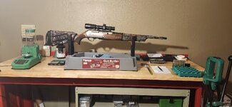

Hello forum, I have a few question on the loading of my BAR which was made in factory with 18.5" barrel on a short run for LL COTE. My plan is to load the 180gr Oryx bullet. First off I would like to thank you alls in advance and introduce myself as I've learned alot here reading posts and collecting knowledge before I started reloading but have never posted. For the past few years I've been, studying, watching videos, collecting material and equipment, and succesfully loaded my bolt action 7rem mag and 300wsm this past fall. I was a machinist and currently a millwright so picking up reloading was fairly easy as alot is about measuring, consistansy, and paying attention, however still new to it and learning. I love shooting so much that it hurts, as I learned this fall developing my 300wsm 200gr loads with no break haha ouch.
I plan on full lenth sizing for BAR with a .003-.004 bump on shoulder. I have H4350, RS Hunter, N560, IMR 4350, Hybrid100, N165, Acurate 4350 I am leaning toward the Hunter but am very open to any suggestions or data. Bullet and brass will be Norma Oryx 180gr and Nosler brass.
1.) Is the chamber generally short in a BAR?, I ask this because the case lenth on once fired nosler AB 180gr factory was under saami after firing 2.469 case OAL (saami calls for 2.474-2.494) and also the shoulder only grew .005.
2.) Does something happen during firing a semi auto which would cause the case to smash? And should I just trim to the under saami spec 2.469 like the cases on once fired? Ask this for same reason above.
3.) Has anybody loaded a BAR, and even better with an Oryx 180 gr bullet? Advise welcome.
4.) Will the short barrel and being semi auto change what powder I can and should not use?
5.) How much of a pain in the ass would it be if I asked somebody to do a quickload for me is it?
Like I said thank you guys so much, and nice to meet you. Hope you can help. Let me know if I can help you help me. Sorry for the long read. Chesty

I'm good on my bolt actions, loaded those in the fall, working on the BAR in 30-06 with the Oryx bullet. Gonna use it for spring bear if I draw and the 7mag for longer shots.
Update chamber is pretty short. To jam Im seeing 3.315 as max bullet lenth available on the oryx or 2.791 with hornady 30 cal bullet comparator.
Going to start with 54.5 gr H4350 powder and CCI large rifle magnum primers. Start seating .020 off my version of jam. From there I plan to work up powder and fine turn seat last. Any thought? My thinking is Scotty has had good results with h4350 out of the bar and will give me a touch more room to work than the Hunter powder.
