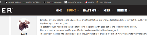

Ernie has given you some sound advice. There are others that are also knowledgeable and shoot way out there. They all are much better than I.
My shooting is out to 800 yards.
To get started you need a rifle capable of shooting long range with good optics and solid mounting system.
Next you need an accurate load for your rifle that has been verified with a chronograph.
Then you put the load into a ballistic program like JBM Ballistics to create a drop chart. Now you have to verify the numbers at distance and fine tune your real world results with your drop chart.
Once this is done, you can laser, dial and execute the shot. It takes time but the effort pays off.
