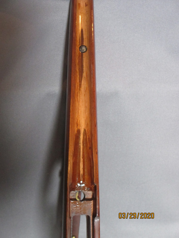

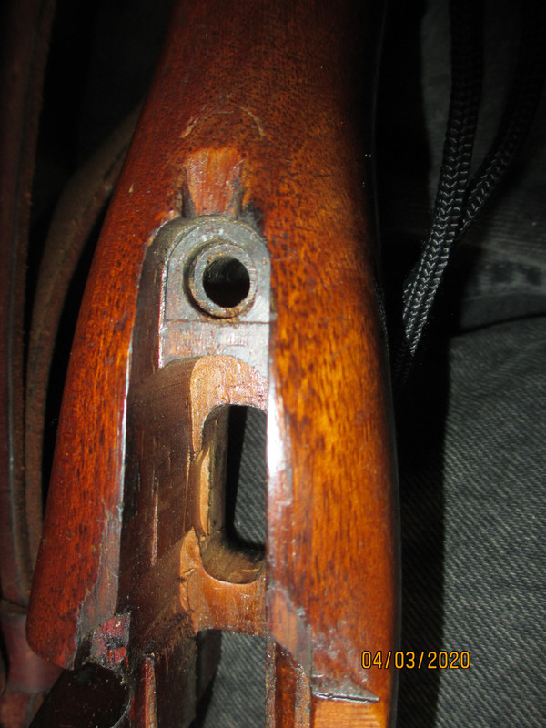

Thanks Guys- Like I said- intimidating...and I appreciate the advice. As you say, I may have the cart before the horse in opening the channel. You can see the rub marks on the right side of the barrel in the photo above. I have included some photos of the bedding as it currently is. To me it doesn't look to bad for a 60 plus year old 7 Mag (Commercial Mauser 98) that in its day got shot pretty consistently for a guy working rotating shifts and raising a family.
The front could probably fit a little tighter, but not by much and it all looks pretty solid.
The rear may have a little oil incursion, but seems very solid and has good solid impressions from the tang.

One note, The stock had a "ridge" under the chamber area that Dad must have sanded out at some earlier point. There was some pressure under the barrel about half way up the stock but it was mostly from the right side, There was no support under the chamber before I started. Still isn't... you can see it as the lighter colored wood in the center just forward of the action. At this point I think that would be all I would try and bed...but I should probably shoot it now that the barrel is free. As you point out one thing at a time. But now I will have to wait.... :roll: :twisted:

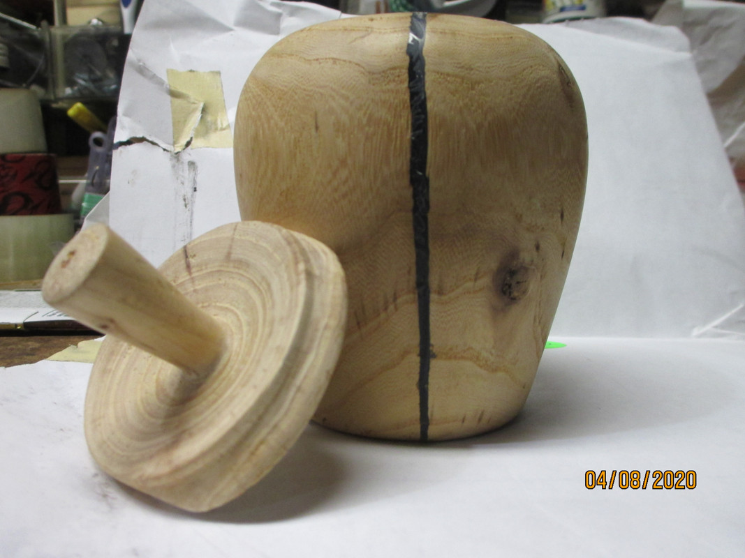

Doing some wood working in stead that just happens to need a crack patched. Good practice instead. More details later... Thanks all for the advice. CL
Well- I haven't got around to shooting Dads rifle yet. Between the "situation" and my bad shoulder I cant crank up the energy or decide that its a good thing to do so just yet. However, I have done some work w/accra-glass. The "apple" below was turned by my father some years ago. Whether it cracked on the lathe or from sitting and drying out I do not know. I did the sanding and added some pieces so that the top "locks" in place with a 1/4 turn. (Iwonder if that's what Dad intended??) I put some tape down the outside of the surface and attempted to press the glass through the crack from the inside in an effort to keep the glass from expanding over the grain on the outside and having to sand that out.
That was successful but the surface of the glass, of course followed the tape exactly and so was a little low in places. it also took on the texture of the adhesive on the tape, most of which I was able to sand out. Aside from that, it appears an excellent bond and very solid.
I also used the accra-glaas to mend the break in a plastic vacuum cleaner hose (y) . Rock solid for the first time in years! :grin:
