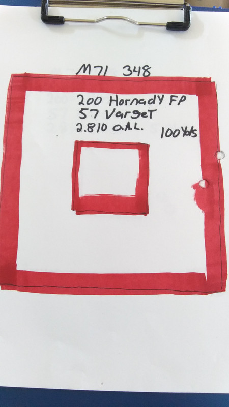

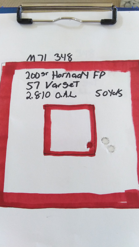

Loaded up 5 more to shoot on a short jaunt I had time for today. Same load as the other day, the only thing different today is that instead of using those old CCI primers from the 90's, I loaded up with much newer primers.
Shot well at 50. Just over 3/4" but to the right. Primers making that difference? I doubt it, but who knows. With my eyesight and iron sights it's probably the Indian and not the arrow.
I had 2 more to shoot, so I set up another target at 100 yards. I contemplated fudging my hold to the left, but thought no.......if it does the same thing it will double that amount at 100. Sure enough. The 50 yd group was 1.5" to the right of center, 100 yards was 3" right of center.
2 shot group at 100 was just under an inch. Don't know why it or me is shooting right, but I guess if it keeps this up I'll drift the rear sight over.

I note that the photos show in a separate window when I click on the postimage icon. The results are encouraging. Just a bit to the left, and you'll have a load that is precisely on target.
