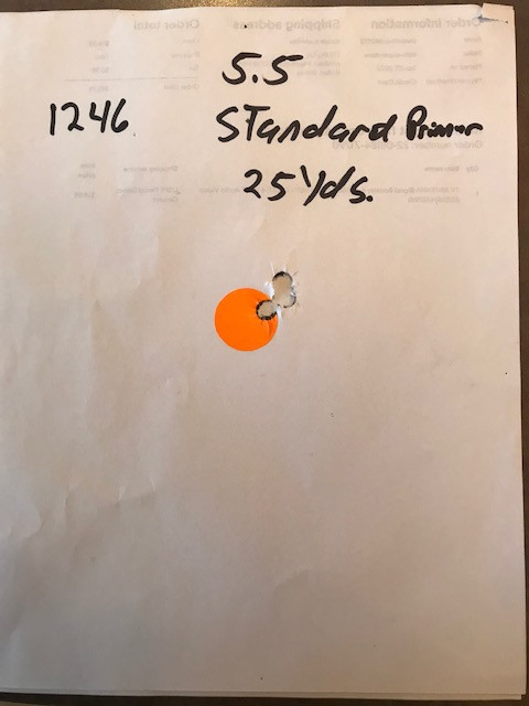

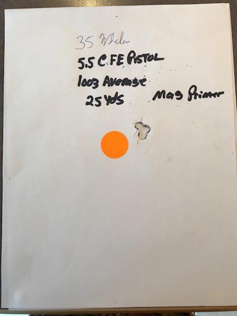

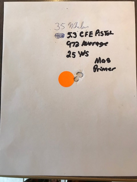

So I got some more results to post if it interest any of you in following along. Seen some trends of intrest when looking back over my targets, and had one surprise.
Something that is apparent when looking over the targets, the Unique acts more like a lot of ball powders in this set up. Not terrific, then when you hit it, it's on. A lot of my targets have 2 together, 1 out. As you get closer the 1 out gets closer, then next charge it's on. Go past that, same result, 2 together, 1 out. Nothing bad with the mag primers, but 1 out until you hit it.
The CFE acted more like a stick powder..........a wider range of very similar good performance, then as you get away from ideal, it starts opening up. The dissapointing part of the CFE is that I think I dislike it's burning characteristics even more than Unique. Left flakes of unburned powder at the case mouth, and in the bore. Just as dirty as Unique, but shot well across multiple charges.
The next thing that was apparent, was that across the board it shot better with Mag primers than with Standard primers. The surprise was that the standard primers produced higher velocity in the neighborhood of 60-80 FPS with the same charge.
I thought maybe my chrono was lying to me, but I tested it twice back to back shooting my original load of 4.7 Unique, but with standard primers, then immediately followed with the same load with Mag primers. Same results both times. Standard primers were in the mid 1100's. Mag primers were in the mid 1000's.
I backed speeds off with the standard primers to match the mag primer speeds, and it didn't shoot that great. So I went the other way. Got the same 2 together 1 out I was getting with Unique before, and when I hit 1240 it shot the best........not as good as the 4.7 with mag, but not bad.
This was shots 22-24, so not fouling too bad.
Tried 5.7 that ran about 1290, and got 2 together, 1 out about 3/4". Tried 5.6 and got 2 together and 1 out that was closer.
This morning I tried 5.5 once again. I'm now on shots 33-34 since last barrel clean. Is likely getting pretty bad powder fouled. Was way colder this morning and my velocity averaged 30fps less. Running a pretty tight spread though for this light charge. Standard deviation of just 9 on this test.
So now I have a good sub-sonic load with mag primers, and a regular 22 speed load with standard. The crack level is definitely up with the faster load. You can't cheat physics. I'd like to do some tests with a faster powder yet.
