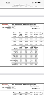

Seeking RL 25 data besides Quickload, wasn't able to find any. Would the middle charge data from RL 26 be similar to start with?
I run 71.5 gr with a 180 in my 300 HH achieving just over 3000fps. Max for Rl 25 in the 300 HH is 72.5 but that proved a little hot in my rifle.
300 HH has 94% case capacity of the 300 wm.
Extrapolation is iffy sometimes but I’m betting you’re fine between 72 and 76gr. Max.

Loaded 6 individual charges in .5 increments from 77 to 79.5 grains RL 25. Got some RL 25 data off of Speer and Alliant. Felt a good crunch and seated .050" off at OAL of 3.475". Just to check pressure and velocity, I aim to get it up to 3100 fps, if not more. My 180 Accubonds ran up to 3260 fps at pressure but settled for accuracy at 3125-3150 fps on my last tests. Hopefully get good results. I believe solid copper does not run as fast as cup and core bullets, if not mistaken. I'll check back soon.
