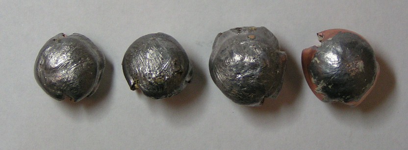

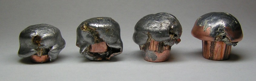

From left to right:
308 Cal 200 AB, 3170 fps: Penetration 11". Retained weight 133.6, 67%
338 Cal 225 AB, 3100 fps: Penetration 12". Retained weight 145.2, 65%
375 Cal 260 AB, 2700 fps: Penetration 12". Retained weight 203.6, 78%
375 Cal 260 PT, 2700 fps: Penetration 10". Retained weight 219.0, 84%

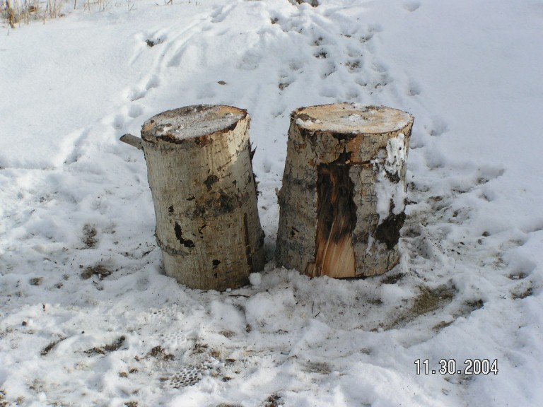

It was nothing too scientific, but I thought some might enjoy seeing the results. The medium was firewood:
Over the years I've found it to give results very close to what one can expect on game (depending upon where you hit the game, of course--no medium contains all the variables a big game animal does). This wood was greener and wetter (and of course, frozen) than what I've usually used in the past and penetration was about 35% less compared with past tests with the 200 & 225 which I've tested quite a bit. I feel it was a pretty tough test at full muzzle velocity.

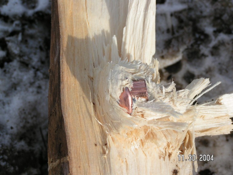

Of note, the 260 Partition was the only bullet that failed to exit the first log:
The 200 AccuBond exited the first but bounced off the second. Both the 225 AB and 260 AB made it 1" into the second log.
All outstanding bullets IMHO. Sorry, I haven't recovered any of these bullets from game yet. Maybe someday I will, but I'm not holding my breath. :wink:

And that "old" 260 gr. .375 Partition held 84% of its original wt. Thru the years, some 60 of them tryin' to dig spent bullets from big-game carcuses, I also have found that the Partition will do just that. Shot after shot, from .338s/.340s using 210-250 grainers. And the 300 gr. from most .375s.
