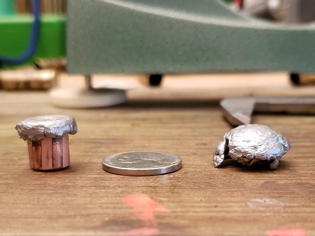

Shot from 20 feet into gallon jugs of water....
XTP muzzle velocity...1,731 fps
A-Frame muzzle velocity...1,705 fps
XTP destroyed 2 jugs and stopped in the 3rd one.
A-Frame destroyed 2 jugs and stopped in the 5th one.
XTP expanded (flattened?) to .800" and had a retained weight of 174 grains (83%).
A-Frame expanded to .610" and had a retained weight of 187 grains (89%).
Its pretty clear which is which...lol.
