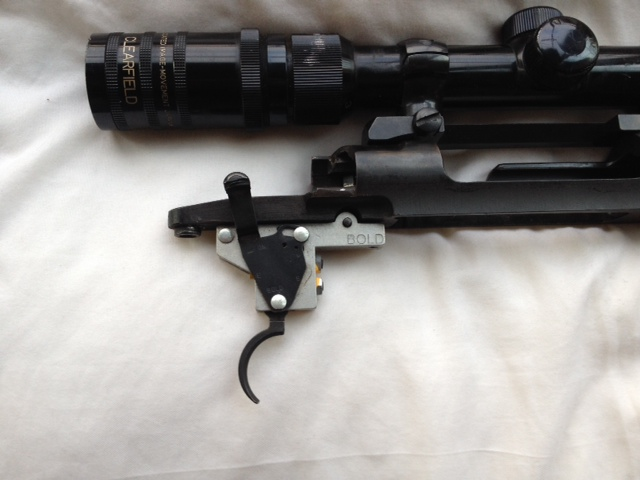

I pulled the stock off because I was curious about how crisp and light the trigger was. Sure enough a Bold trigger in it.

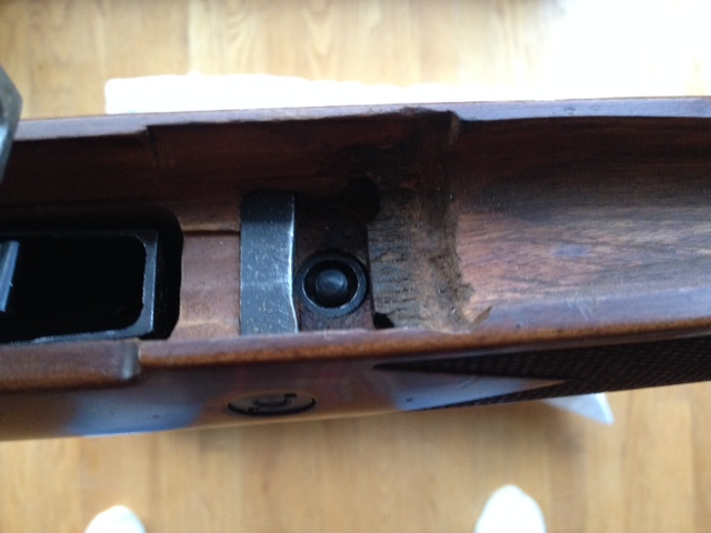

And this is why I check headspace on EVERY gun I bring home. I've seen all kinds of weird stuff laying on gun tables and discovered plenty on guns I brought home. I don't trust a one of them until I check them. This thing has a short front action screw somebody put in it that is doing NOTHING. So this gun probably was sold cheap to the guy I bought it off of because it shot 3-4" groups with every kind of ammo. And it shot 3-4" groups because the recoil lug is able to flop around like a wet fish with every shot. :roll:
Well, a little MarineTex should fix that right up. :grin: Along with the proper screw.
Good job of investigating.

Obviously that has nothing to do with headspace, but with all the weird stuff I've found already, I check that as well so I know what I'm dealing with. Especially re-barrels.
My springfield was the opposite, but with some of the same effect. They inletted the stock too deep causing the front action screw to bottom out on the shoulder of the screw, so never actually holding the action properly tight. Bedding both the bottom metal and the action took care of that.
