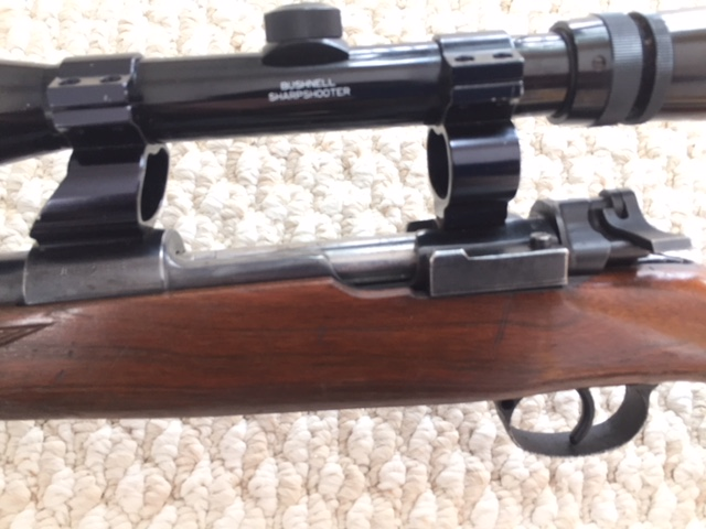

Here is a close up of the left side....it's got some glare but no marks on it at all except for a serial number on the left side of the front receiver ring. It's certainly not a newer style commercial action as it obviously started out life as a military configuration. It does however have the charging hump removed off the top allowing flat bases.

Thanks for the other pictures, unfortunately they don't tell much as to origin of maker but the stock looks like a Fajen design which was very popular with custom builders back in the 1970s.
The reason possibly for the see threw rings was to clear the safety since it still has the original throw lever and will need to be converted before you can put a lower scope mount on it. There are a few conversion kits available for M70 style safety lever conversions which are simple to install but would be best to let a smith do it since I think there is some fitting required I think Brownell's carry them.
Since your going to refinish the stock I would also replace the recoil pad with a Pachmyer grind to fit decelerator pad for better looks and function.
Truck driver, that's not the original safety, it's a slimmer 2 position scope clearing safety that is a good bit longer than originals, with a curved thumb slot. Locks the bolt on the 60 degree up position, and fire on the left like I've seen on some commercial sold actions such as early Golden State mausers for one, there's others but that's one that comes to mind. Works out nice with that higher see thru to slide your thumb up into the curved thumb slot and knock off the safety. I believe it will clear on a low mount but probably wont leave room to get in the thumb slot, will have to flip it off by putting my thumb over the end sticking out.
