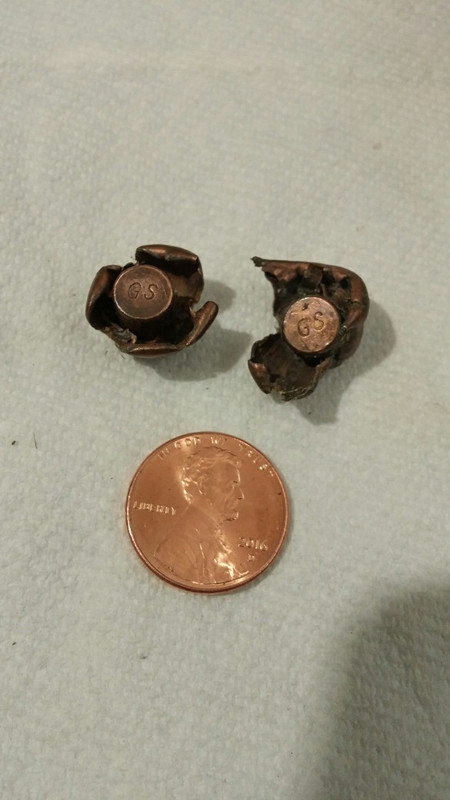

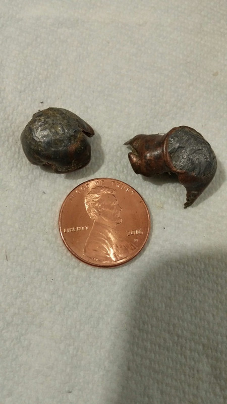

I just bought 200 of the 175gr Grand Slams to shoot mainly in my 7STW or my 7mags.I haven't shot any of the newer ones,but the older style dual core ones worked great. I shot in 145gr and 160gr my 7mags.They worked like a bonded bullet and left very little bloodshot meat around the wound channel.I even shot one deer through both shoulders with the 160gr and there was minimal meat loss.Midway had the 175gr for $18.57 a 50 count box right now,so why not try them. https://www.midwayusa.com/product/1010548979?pid=688346 .Here is the 145gr Grand Slams I recovered.Both these bullets made a lot of bone contact and you can see they held up quite well.I killed a lot of deer with these,these two are the only ones I was able to recover.I see no reason the 175gr wouldn't do the same.
