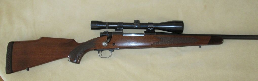

What good is it if we don't have pictures?? Must have photos!

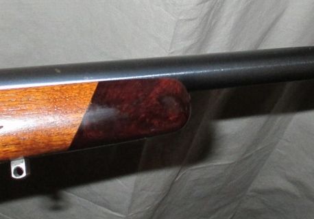

Thanks 6mm and DrMike, I did have the stock bedded, refinished and manzantia wood burl forend cap put on a few years ago, so it is in pretty good shape.
6mm, pictures to follow, I hope.
Nothing fancy, but the manzanita wood came from my late parents property and is special to me.
It is precisely such touches that enable one to own a rifle. Looks quite nice.
