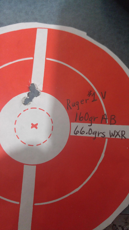

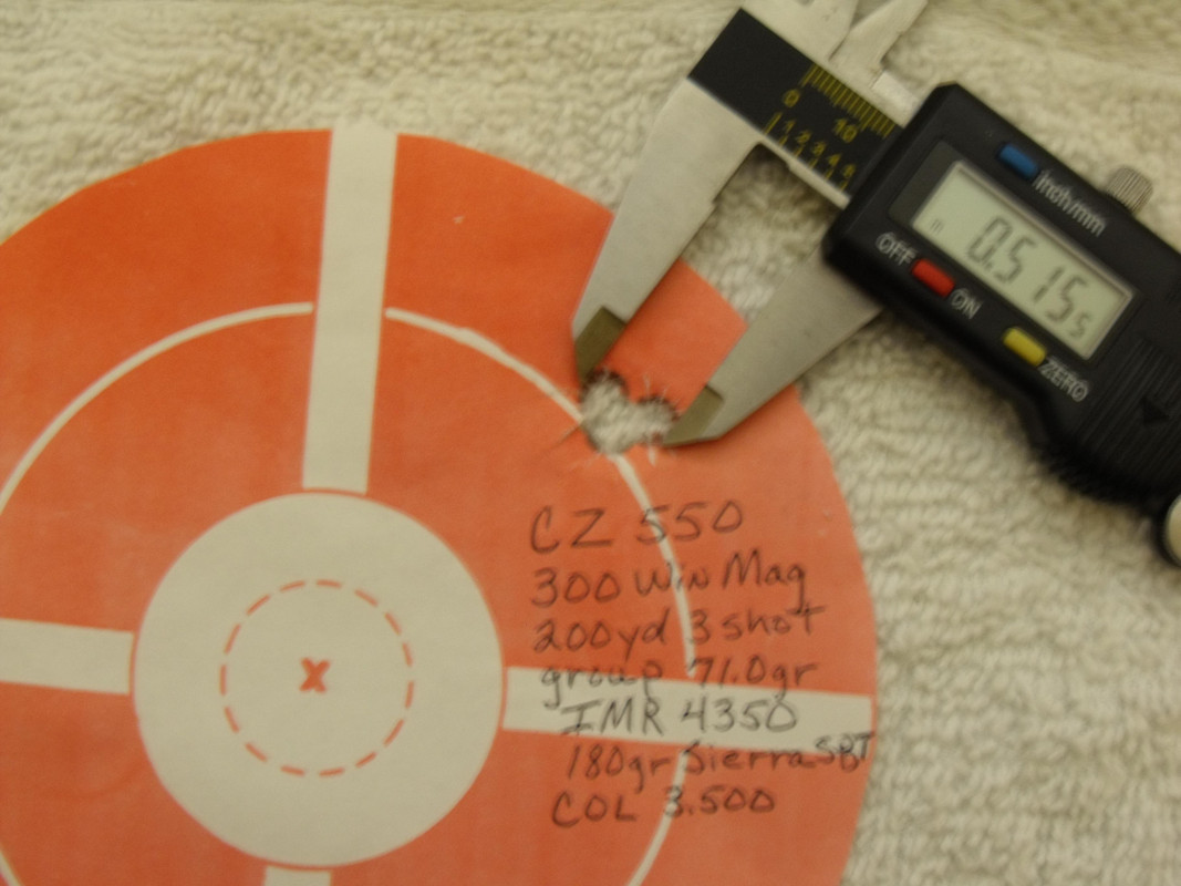

I've used both the Final Finish and The Throat Maintenance System(TMS) bullets.I did see improved accuracy in all riflesOne of them I shot all fifty Final Finish bullets,a couple I used 25 bullets.With the TMS bullets I've had great results after just five bullets.These are not as abrasive as some of the bullets in the Final Finish kit.These are designed to help polish the throat.I used these on a couple of Ruger1's and also a 300WSM.Just five bullets took these three rifle from shooting 1.5"-2" to around .75". As for velocity change,the 300WSM was the only one I noticed a velocity change.
I shot this three shot 200yd group after shooting all fifty Final Finish
This group was after 5 TMS bullets.Before this rifle wouldn't shoot better than 1.5"
That is an impressive 3 shot 200 yd grouping. Very nice!
