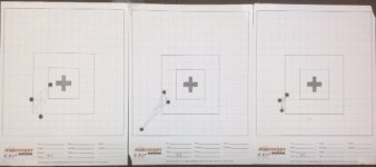

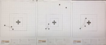

We went shooting today. Results are in photos below.
If you look at the picture showing the group centers it looks like there is a sweet spot in the 42.3 to 43.7 range. I have to assume that the low hit at 42.3 is real at this point. It doesn't change the group center much on a left/right basis, just moves it down.
Given this I am tempted to try 42.5 and 42.7 grains, or 42.7 grains at differing COALs. My COAL of 2.600 is longer than most manuals list other than Nosler, but there is still a LOT of room in the magazine. I will hit the lands long before I hit the end of the magazine.
The 42.7gr group is 1.125 inches, for those who wondered.
Any thoughts?

42.7 grains was again the best load on repeat testing. I tried 42.5 as well as went higher to 44.0. The 42.7 put 5 shots at about 1.6 inches, though shots 2-5 were in a tiny group. I'm not sure if I pulled the first one or if it is representative.
At 44.0 there is a LOT more recoil than at 42.7, and the bolt is a bit stiff but primer looks OK. Accuracy at 100 yards was horrid at 4-5 inches. As a result I see no need to go this high again or worry what speed it might be.
Chrono battery didn't work at first as it sat in the car at 28 degrees. I later chrono'ed the 42.7 load at 2550 x2 loads (2556, 2554), so it is consistent. That is similar to factory loads, though a bit less than I hoped. Not sure if it was the 28 degree weather working against me on Saturday, and I don't know how temperature sensitive LVR might be.
Shortening COAL from 2.600 to 2.570 and 2.545 made the accuracy worse. I did not try to go longer.
I tried a primer swap test, but unfortunately used the wrong brand of brass so that test was useless. I'll rerun that one in the future if time permits.
In the end 42.7gr of LVR gives a very consistent 2550 fps with acceptable accuracy in a non-bedded, non-floated rifle. Given that LVR is a relatively low pressure powder the brass should have a long life. Now if I can easily convert a 308 Lee collet die to a 300 Savage Lee collet die I'll be all set.
