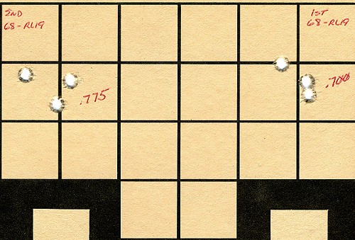

My favorite 7 Rem Mag load is Nosler's 140BT, 68gr of RL-19 and either CCI-250 or Fed 210 primers, which produces about 3190-fps. A 10-shot string produced an extreme spread of 46-fps. 66 to 70 grains of RL-19 all shoot well with speeds between 3075 and 3275-fps. There's about a 50-fps gain/loss per grain of powder. Loading density is in the right range too. Other than some trigger tuning, the stainless Remington ADL is unmodified.
