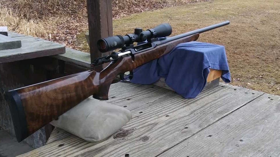

A wood stocked 101. The rifle has literally shot everything I've fed it from 130's thru 165's into 1/2" or less. 130's shot under 3/8", 150's both Hornady & Sierra into mid to high 5's with both IMR 4064 and now H4895, and Hornady 165's shot 1/2" on the button with both IMR 4064 & IMR 4350. Have not done anything with 180's yet other than initial testing with Hornady 180 round nose.
Feeding, extraction, & ejection has been smooth and spot on flawless. I almost wish I could fault it more being it's not American made, but man, they made themselves a good rifle. Only thing I dislike is the ergonomics of the push button safety on the rear of the bolt.. I'd much prefer the side safety on your 100 I believe just for pure ease of function.
They used some burled walnut to stock it. Pffffft. Those Germans must think they're pretty hoydee toydee. :LOL:
I picked this rifle up off the used rack and it was listed as being used as a display model at shows. I can only surmise that it was possibly one of the hand picked rifles used by the Sauer reps early on when they were first introducing this model to the American market. Not to say there's not others, but I haven't seen a wood stocked 101 prior or since with this kind of wood on it. Purely a guess, but either way I guess it's staying here.
