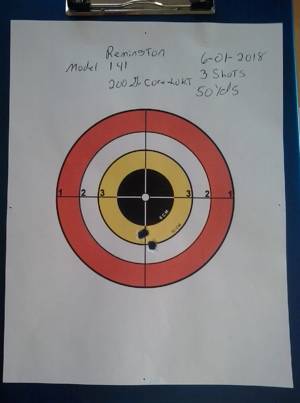

This is what this same rifle does with the factory ammo.
You will get a pile of venison with that load
That's a deer getter load. May not be as tight as the factory but lots of deer get killed with far worse groups than that. Go forth and slay some venison. Dan.
