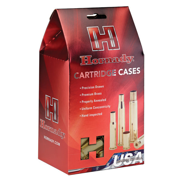

I may have a new bag (50 pieces) of Hornady 250 Savage brass if you are interested in it let me know.
As Guy said Hornady is making the great 250 Savage.
Unless you are set on reforming there is a lot of Hornady 250 Savage brass available (Midway, Graf & Sons, Midsouth, etc.).
