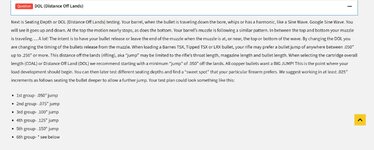

What bullet are you using?
If using a cup and core bullet, I would make the OAL long enough to fit in the magazine, and start at .010" off the lands.
If its a Barnes or copper bullet, I would make the OAL length long enough to fit in the magazine, and start at .050" off the lands.
Find a tune with your powder charges, adjust seating depth deeper if needed to tighten groups. Barnes has the recommendations on their website on seating depths.
