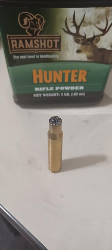

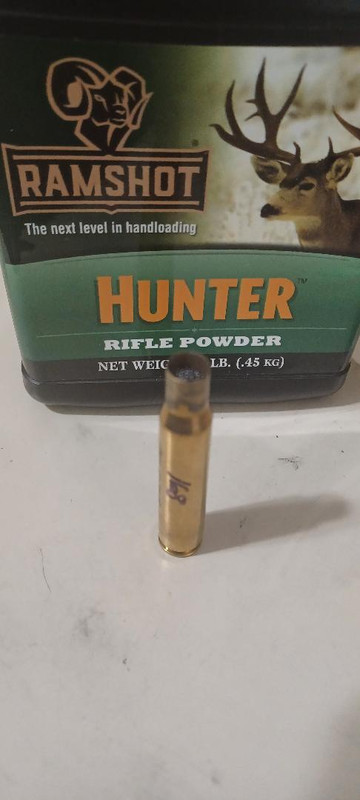

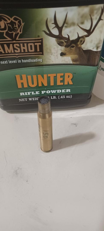

It wasn't compressed,but most loads in the 308 Win are going to be a full case anyway.Compressed loads are not a problem as long as it's not over compressed to the point that the bullet will actually creep back out longer than when it was originally seated at.One other thing to also keep in mind different brands of brass have different case capacities.This can also change with different cartridges.I use Winchester brass in my 308 Win.I did a test on day with the same load using Winchester,Nosler and Remington brass.The Winchester and Nosler brass was giving me group sizes around .5" and was close enough I could have mixed those cartridges and never noticed any difference.The Remington brass was a lot different.My group opened up to about 1.25".Now that was a significant.More than likely it was due to difference in case capacity changing the load a little.Since that time I started paying more attention to case capacity of different brands.I first tried weight sorting the brass and found that to be a waste of time not really knowing where to start and how to group it.I ended up with five cases in this group weight and ten in this group weight and twenty in this group weight,but what am I going to do with these cases of different weights?I now just go by brands and not mix the cases of different brands.I haven't checked the case capacity difference between Winchester and Remington in the 308 Win because I haven't loaded any with Remington since that day.But in my 30-06 Winchester brass has more case capacity than Remington and in my 7mag Remington case more case capacity than Winchester.The way I check the case capacity difference now is Use a ball powder and fill a case full to the top and compare.
Here is some pictures of 30-06 brass filled with 67.5grs of Hunter showing the difference in case volume.
Winchester Brass
Lapua Brass
Remington Brass
