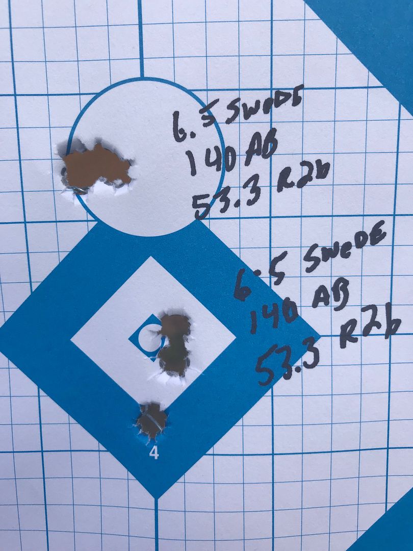

I did some playing around with RL26 and the 140 Accubonds back a few years ago and using QL I came up with about 2890 with them. They shoot like crazy.
Or at least good enough for me.
This was using Hornady brass if I remember correct, and I dropped it a bit for the Lapua brass.
I’ve shot this load enough now to know anything subpar is on me more than the load.
