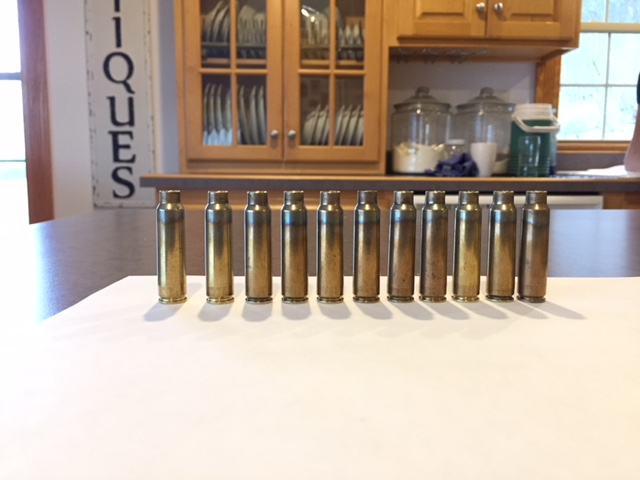

Not a good picture, but here is some 22-250's I done a while back. For me these are about right, but you don't want the heat line extending much lower on the case body than this. Initially you might want to keep heat on them just long enough to anneal right to the shoulder and no farther until you get comfortable and used to the procedure.
