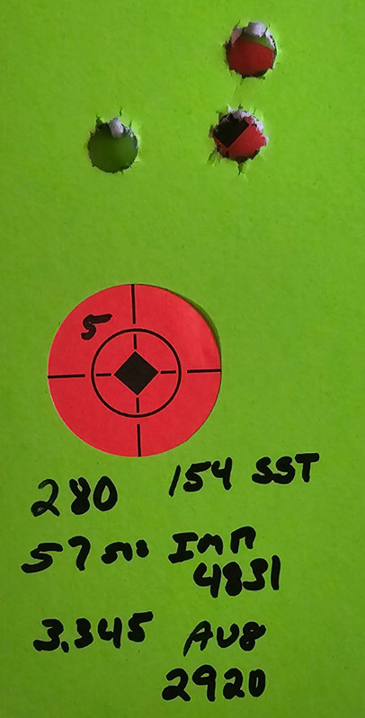

I made it back to the range today to test and Chrono some loads in 3 of my rifles. 280 Rem, 308 and 7-08 Had some really good success today in all 3 but the one that I was pleased with the most was my 280. While the accuracy was just under an inch the velocity averaged 2920 with a 154 gr SST bullet. That should perform quite admirably on any white-tail or hog. I could possibly get it to shoot a little better but this level of accuracy and velocity is well within my realm of satisfaction.

I've used the 154 gr SST in my 280 for several years and have had really good success with it. I've tried the 139 SST in my 7-08 several times but could never find the accuracy I wanted. I decided that I was going to find a seating depth and powder charge that would work.
Enter H-414, I have 8-10 lbs of the stuff. I loaded up several charges with different seating depths and viola, I found what it liked. The bullet wanted a good "jump" and a healthy dollop of H 414. It rewarded me with 3/4 inch group and almost 2900 fps, 2890 to be exact. I did have a couple other charges that gave me a little above 2900 but accuracy wasn't as good.
