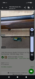

I just purchased this exact rifle. Winchester barrel marked 358 win mag. it does use necked up 338 brass for the loads.
