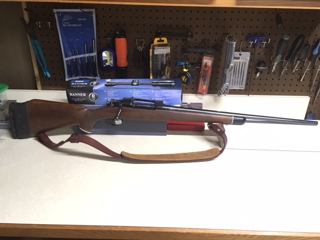

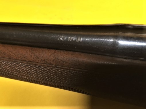

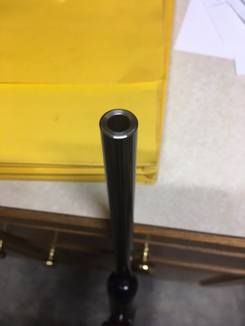

My 03 Springfield with a barrel that had seen its better days, must of got tired of not being payed any attention to, and ran off. Not sure who she was out galavanting around with, but showed up back home with a bigger bore and a new tattoo. :unsure::D
Well, while she was playing around, things must have gotten weird for her to be sporting a bigger bore and a new tattoo. Maybe it's for the better. Actually looks rather nice.(y)
Ha. Thanks. Need another rifle project like a new hole in my head, but it was finally make the decision to do something with it, or else there it would sit. The one nice thing is I already done all the work before bedding it and free floating the barrel etc, back when it was a 30-06, so it should be ready to roll.
I specifically requested the slower 1 in 16 twist as I plan to do a lot of learning and experimenting with cast bullets with it. Jesse assured me that twist would also handle up to 250 grains easy with conventional jacketed bullets.
Yeah, the 16 twist will handle the 250 gr pills. I built two Whelens--one with a 14 twist and the other with a 12 twist. They will handle the heavier bullets, but it isn't clear that I gained all the much over the more traditional 16 twist. Normally, I'd be suspicious if my girl showed up with a tramp stamp, but I kinda like that one.:giggle:

I take it this is a JES rebore with cut rifling so since you plan on shooting lead and cast bullets you might consider using powder coated lead bullets till you smooth out the bore.
Powder coated bullets will cut down on lead fowling the barrel and will also cut down on the smoke from burning lubricants.

Yep a JES rebore. I'm gonna start out running some Speer's through it to get an idea of how it shoots and I'll see how bad or not it's coppering up and go from there. Thanks for the suggestion.
