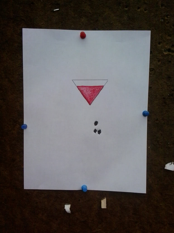

FilmJunkie, you asked about good loads in not necessarily heavy bullets. Start below this and work up in your gun as it is right at max load, but I have a lot of confidence in it. 47.5 gr IMR 4831. Rem brass, CCI 200 primers, Sierra 85HPBT. Seated .050 off the lands to start has worked out well for me in this setup. In a 22" barrel, velocity should be at or nipping on the heels of 3100.
In a 18.5" thin barreled Model 7 at 100 yds. Has remained a consistently accurate load when I shoot it, in a otherwise sometimes finicky gun. Haven't messed with the load in this gun beyond this.
And just last week in a 22" M 760 pump gun at 100 yds. Same everything including seating .050 off lands. This gun when it came was shooting factory ammo like it was chunking rocks. A complete disassembly and cleaning including removing some rust and gunk from both the shoulder and neck area of the chamber got the same factory ammo down in the 1.5" area, but this load shrunk it in half from there.
In the 760 after this I tried both 47.4 and 47.7 gr's along with changing the seating depth from .050 off to .035 off. It shot every 3 shot group in the mid to high .6's with all changes I tried. Point of impact was all that moved some as I made changes, so I'm back to 47.5 and .050 off. Fairly wide and forgiving accuracy node up at the top.
