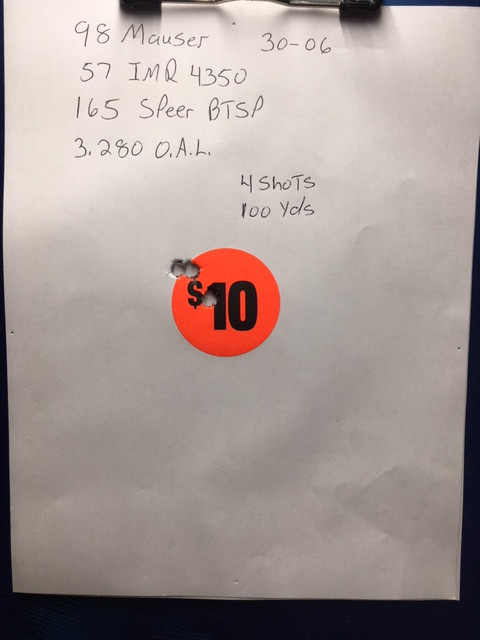

My old Mauser 30-06 has been steadily trucking along during limited testing since bedding it, but I've had it out of the stock 3 times since, just taking care of some minor things.......did anything I do help? Maybe a little, maybe not, but it's not getting worse for sure.
Tested it this evening after doing a little more fuss work. Doesn't look like it, but there's 3 bullets in the top 2 holes. The hole on the right measures .360.
4 shot group is 3/4 so staying respectable.
Put one of those M1 Garand cotton web slings on it to carry it hunting this yr. Never had one. Good width, easily and quickly adjustable, carries nice. Might not be the last one I get.
Excellent work with a great cartridge. Obviously, you have a fine rifle to work with as well. That load appears to be ready to carry afield.
ST,
That is some excellent shooting. Your rifle and load is tuned and ready to hunt. Nicely done.

I just run used unsorted Remington brass that is sized initially and made sure it chambers in this rifle. I don't weigh brass or turn necks, just load what's in front of me.
Be interesting just for fun to feed it top components to see what the ole gal would do. Lapua brass and match bullets for example. Maybe no better, I don't know, but it sure acts like it's fond of producing some tight clusters.
