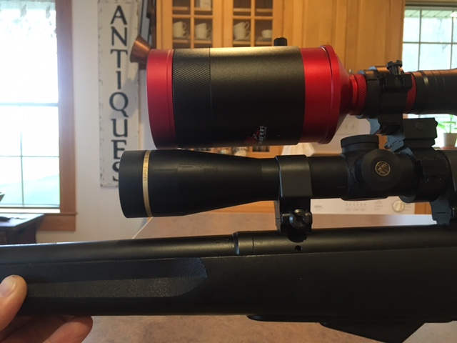

How close is to close? I always try to mount my scopes as low as possible for the obvious reasons. 2 of my rifles only have about .005"-.010" clearance from the bell to the barrel, or the 20 MOA rail. Wondering if maybe that has something to do with the scopes coming loose? You can see day light so I figured it was ok. Thoughts and opinions welcome...

On my 7-300 which is braked, it's about .010" clearance to the rail...On the 7-08 which is also braked, it's about .005" from the barrel...I do properly torque base and rings with a Fat Wrench. But these 2 rifles I just noticed that my scopes were slipping forward my last trip to the range. So I'm not exactly sure WTF is going on with my base/ring set up. The 7-300 has weaver 20 moa base and low 6 hole picatinny rings, and the 7-08 is on low talley lightweights. I've never had an issue with scopes slipping in 20 years...why now?
I just dissembled my 7-300 base/rings and I put red loctite on the base, and then I put nail polish on my ring cap screws. Will see how it holds up...If it doesnt then, I dont know what to do from there. I'm at a loss as it is...

On the 7-300... you could take a file to the front of that base and give it some more room....its also too close in my opinion.... knocking that edge down 30 to 50 thousandths wouldn't hurt the base at all as far as function goes.

Each to their own, but you couldn't pay me to run those tight of tolerances on a hunting rifle I was depending on.
