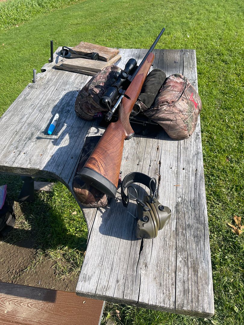

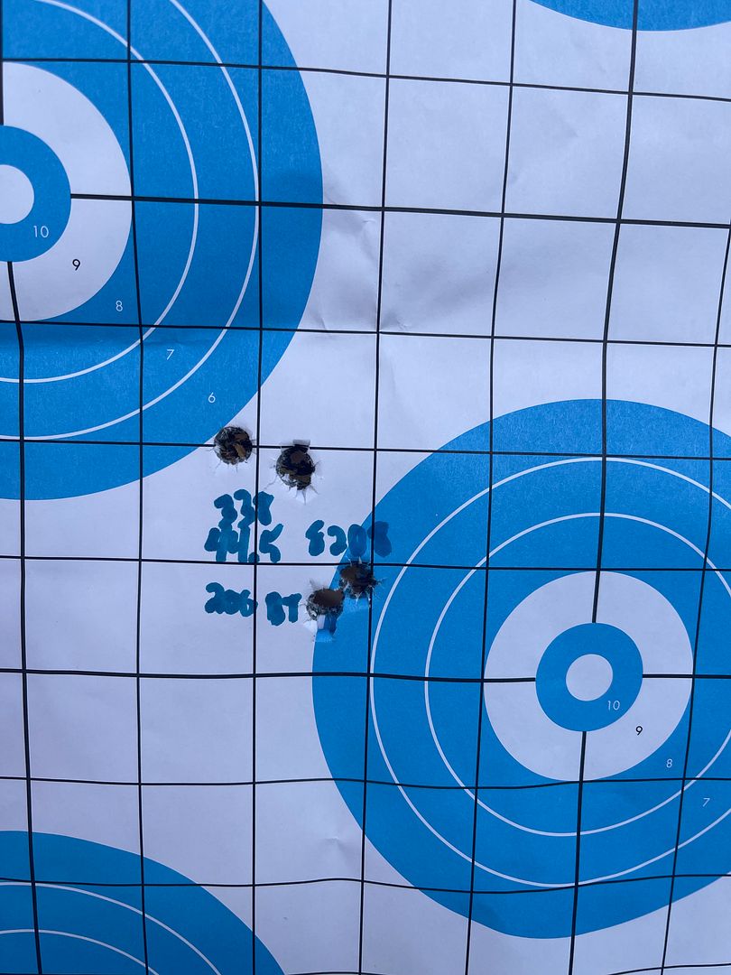

I picked up a Kimber 338 Federal back in the winter, but I got some dies and a bunch of Sig brass, used the expander mandrels and necked up 50 pieces. Decided to try it out with a few bullets I had on hand. JD sent me some 200 BT's which I was hoping were going to be the stars of the show.
I put an older Zeiss 2-8 on the rifle and it seems to fit the rifle rifle.
Anyhow, I loaded up some test rounds with the 185 TTSX, 200 Ballistic Tips and 200 Speer SP's.. I used 8208XBR across the board.

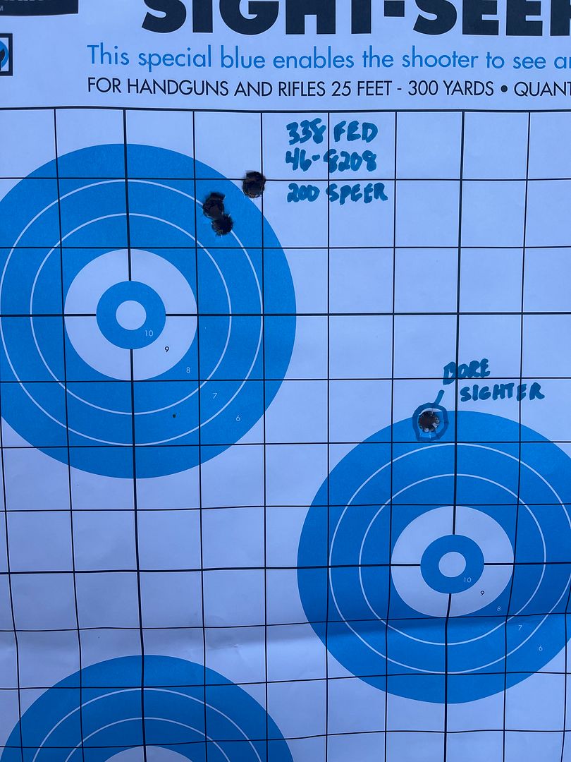

So, I pulled the bolt to bore sight it, got it what I felt was close and used the 200 grain Speers for getting it on paper.
I was in wow actually, the bore sight hit the paper, and the first 3 shot group with 46 grains of 8208 should have been the end of my shooting session, but I hate pulling bullets..

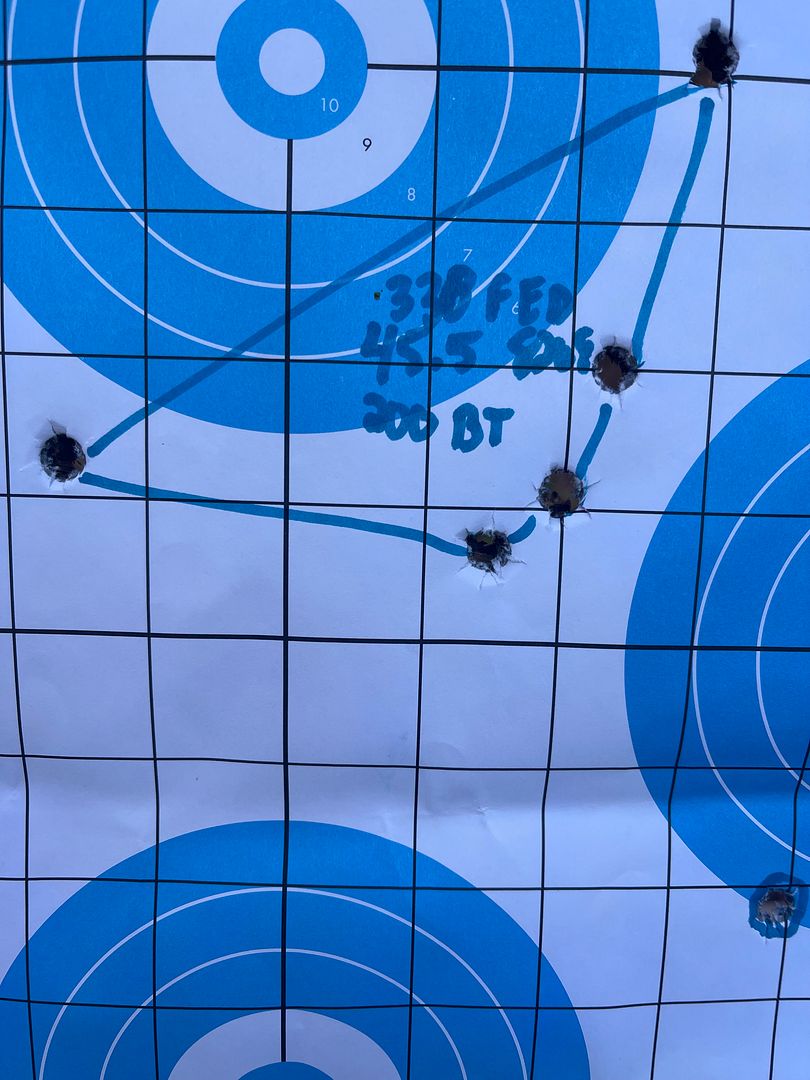

200 BT's
Something wasn't clicking with them.

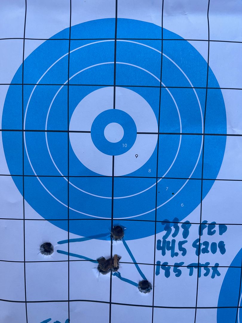

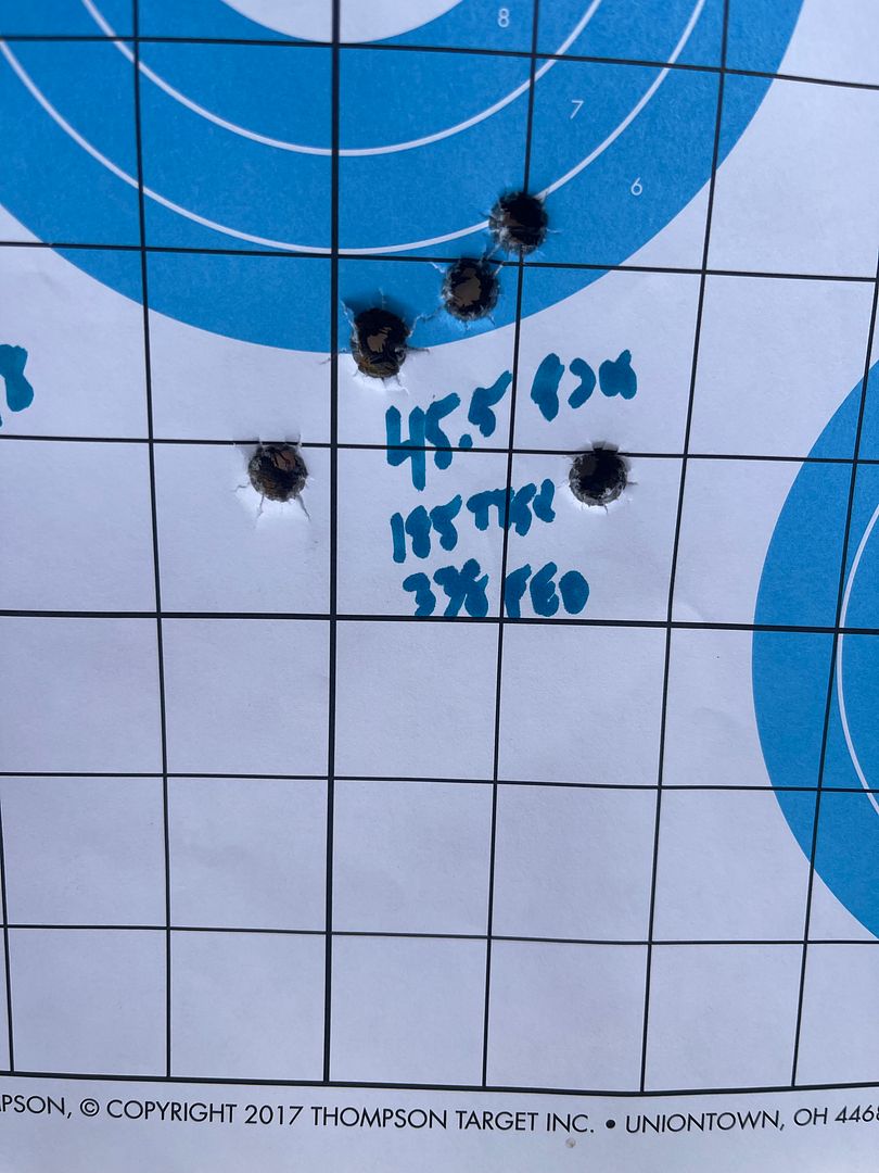

185 TTSX

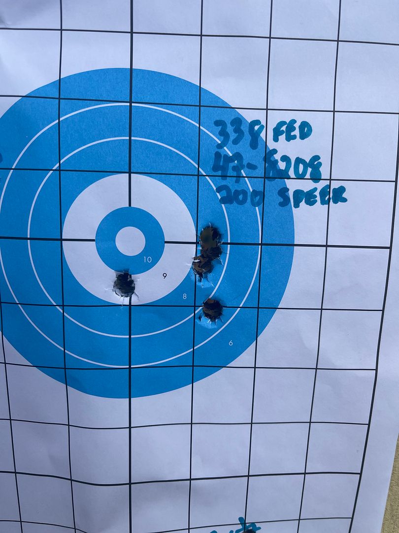

I had one more charge increment of 8208 for the Speers..
So overall, I think I am going to go back and monkey around a bit with seating depth and see if I can't get all 5 to play well.
Also, I thought I could sneak a range trip in with the trigger the way it was, around 3 3/4lbs. Well, light rifles and heavier triggers aren't real hot for me. I have to concentrate too much and it's just not much fun. I'll pull the stock and get that trigger lightened some and I think I'll have something.
Should be ready for deer season shortly though. It is a handy rifle though. Never used that 200 grain Speer, so if you all have any experience, let me know. I am thinking they will be good though.
I think you're onto something by playing with seating depth.

That first 200gr Speer load looks ready to rock to me. Should be a hammer on deer for you.
Scotty,
Nice looking rig right there. It would make for one heck of a woods rifle for deer and elk in the black timber. That 200 gr Speer with 46.0 grs 8208 is ready to hunt.
Nice work.

I have 3 different bullets for my 338F. One of them is the 200gn Speer, 200gn BT and 210gn PT. In my last 338F the Speer grouped the best. I now have Sav 16. Need to start over again. I'm hoping the PT will group.

Looking good Scotty and I like the wood on it.
While you have the action out of the wood, I would check the bedding if you hadn't already done it.
