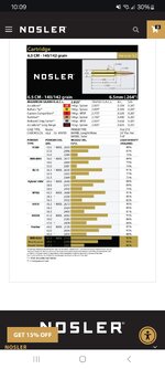

Hello, gang. I was gifted some various bullets by my uncle who was downsizing his reloading supply cabinet. One of the things he gave me was about 150 of the 140gr Partitions in 6.5 caliber. He used them in a .264 Win Mag, but my use would be in a 6.5 CM. Anyone here loading and using them in the CM, in place of the "sexier" bullets that are all the rage today? What are your favorite loads and results?
Thanks,
Brian
You have a very generous uncle. If you are already loading a different 140 gr bullet and get good results that's a good place to start.
