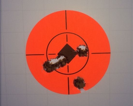

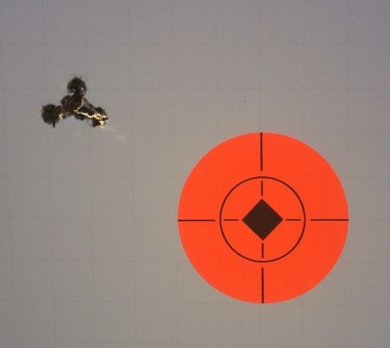

My 260 rem load developement is coming along really well. I have two loads worked up that are consistant performers. The Hornady 123gr Amax and 142 Sierra MK. The Amax load is probably the most consistent but a touch on the slow side for a 123gr bullet at right at 2800fps, the 142 is going almost as fast as the 123 amax.
123gr Amax with H414 @ 2800fps
100 yards
200 yards
142gr Sierra MK with H4350 @ 2775fps
100 yards
I’m really liking this 260. Even with the ring marks in the brass its shooting so well I’m not going to mess with it. I have been using nosler brass in this one and it has proven to be very consistant.

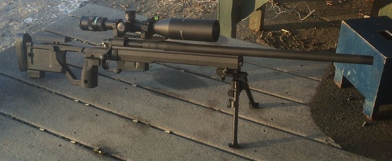

Here is my 260
Excellent results. You have every reason to be pleased with your work on those loads. Since you're shooting for accuracy, I wouldn't be overly concerned about velocity at this point.
I agree speed isn't as important but it sure is nice. There are a few other 6.5 bullets I want to try. The 129gr nosler LRAB, the 123 scenar, and 140gr berger vld.
Nice rifle!, it just looks like a shooter and from the looks of those groups it appears to be one. (y)
