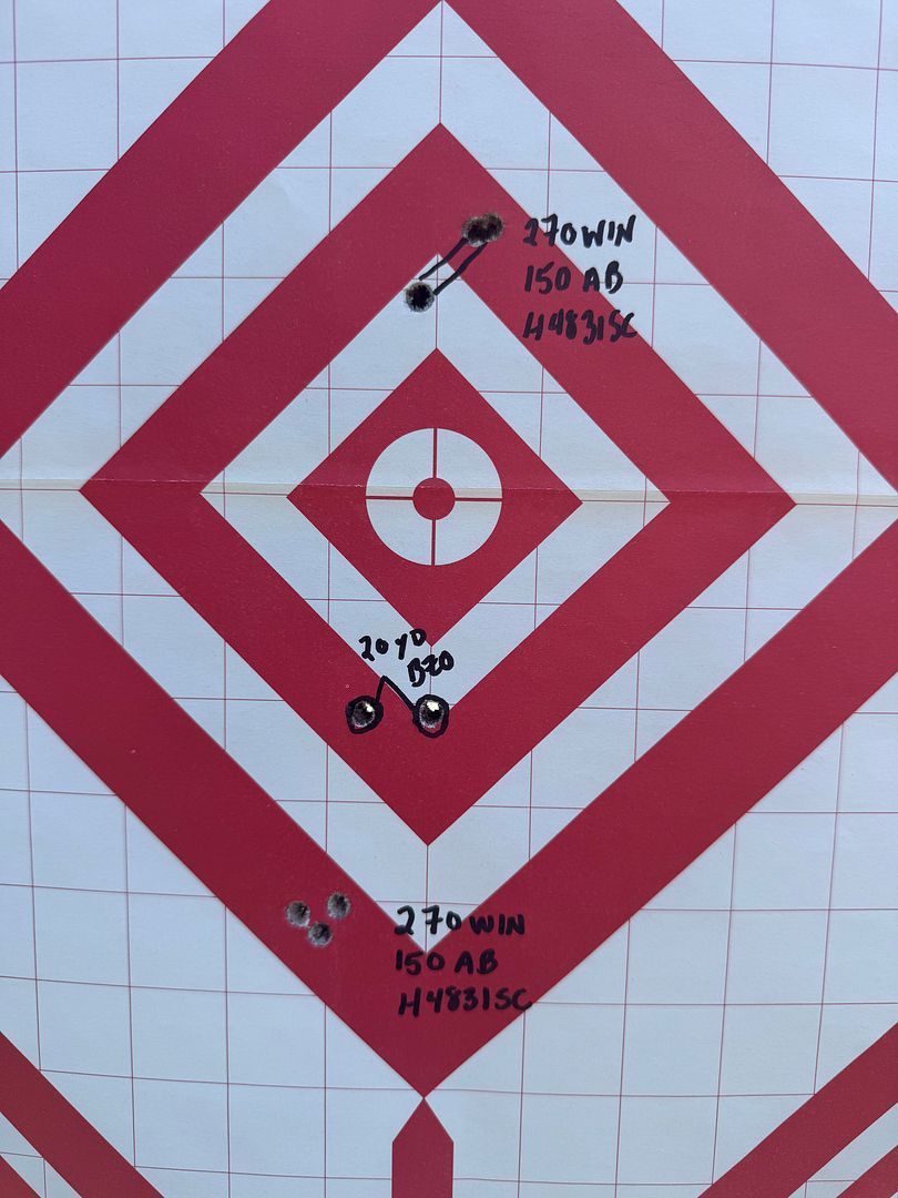

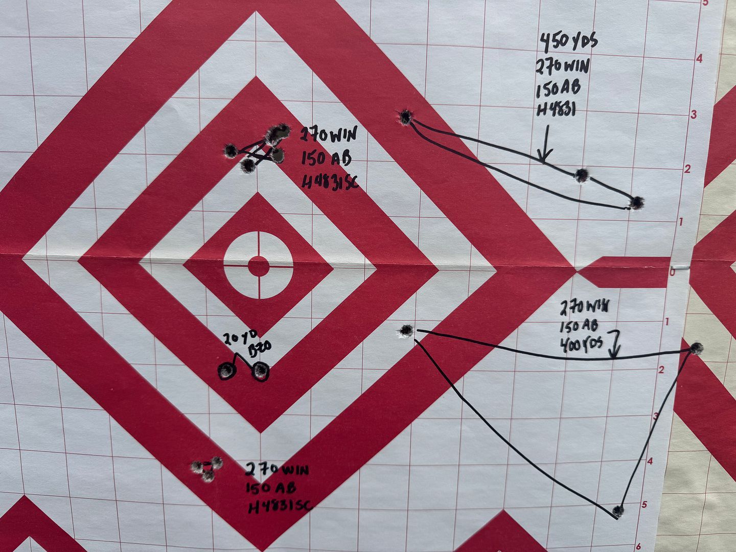

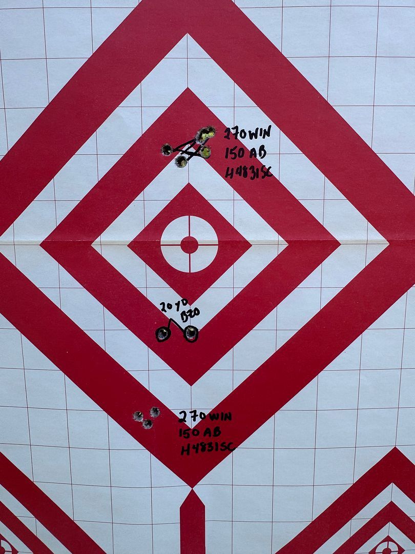

I put a S&B 3-12 back on my Kimber 270 Win. The load I am using is H4831SC, WW cases, CCI200's and 150 AB's.
I started off at 20 yards.
First was left, adjusted a little right, shot the 2nd one. Went back to 100 and shot the bottom 3. Made one adjustment and shot the next 3.
Then I loaded up 3 more to verify the zero was good enough.
Having 6 shots MOA was good enough to me and the wind was howling.
Took it back to 400 and 450 in the wind just to see how stuff was moving.
So, to answer your question, the AB's shoot great, the 150 BT's shoot exactly the same with all else being identical. My 150 BT's are some old stock I got from the Bivwak site back in the day you bought a bunch at a rip. To be honest, I'd use the 150 AB and BT interchangeably on elk and such. The BT is a tough BT and is almost too tough for me to use on deer.
