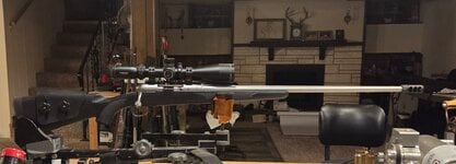

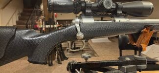

I have a 26" SS 10 twist 5R Savage Large shank barrel coming. Also a few hundred pc of Sig 277 Fury (6.8×51) Hybrids ( steel case head, brass body) .
I'm also have dies coming.
I can not find any data on this cartridge. I plan on shooting 140gr and 150gr bullets. I'm betting H4350 or H4831SC might hit the spot. This is the first cartridge I've had that doesn't have any info on the web...even Wildcats.
If anyone has any reloading experience or load data to share I'd appreciate it.
Thanks.

Shot my .277 Fury Sig Cross today, 20" Barrel . A bit bummed with the velocities with factory ammunition. For example, the 135 grain velocities were about where a 16" barreled gun should be. I was hoping for more like 3000 FPS, which is about in the middle between 16" and 24" velocities per Sig. The 150 Hybrid Hunter came in an avg of 2867 FPS and SIG predicts 2830 for the 16" barrel on the box. So my 20" gun would only match the 16" predicted velocities. Bummer. :( But 2867 with a 150 grain AccuBond is still plenty for the biggest Bull Elk in the woods at any sane range. I was hurried at the range, so I know the rifle shoots better than I did today. Slight breeze, target not perfectly secured. 2.5-8x Scope. 135 grain brass cased ammunition and 150 grain Hybrid hunting Ammunition. One thing is for sure though: Sig Cross rifles shoot very well. I have three. They are ALL MOA rifles, be it my STX Cross in .308, my .300 WM magnum with steel barrel (not Sawtooth version) and now my .277 Fury. I love these rifles. I know money doesn't grow on trees, but a rifle this good, in a folding chassis costs just a bit more than an MDT HNT26 chassis (which I also love! :)) My point is that these are great rifles.
Good to hear a range report. 2800+ from a .277 cal 150gr in a case roughly 308 size from a 20" barrel is nothing to sneeze at. My 24" barreled 270 Win did right at 2900 fps with 150s! What kind of loads are you working with?
you are of course correct as that is still impressive out of a 20" barrel. My thoughts exactly as this is basically a short actioned, short barreled, .270 Win with 24" barrel performance. ...and that is enough for the biggest Bull Elk that walks at any sane range. IF Sig made the Cross in good old '06 family cartridges, I would go that route as I love them all....But Sig is a no go with those. It is either .308 length, or .300 Win and all the new PRC cartridges. I bought a .300 Win in a Cross but I much prefer something just a tad milder. My next project was to rechamber or re-barrel a cross into .284 Win....but given these velocities, that may be a pretty moot exercise :) By the way, these are the factory Sig 150 grain Hybrid Hunter Loads.....Hybrid refers to the case. They are good old 150 grain Nosler Accubonds. It is also very compact in an Sig Cross with a folding stock. All good!
Thank you. The reason I was asking was because I wanted to get a feel for what the factory ammunition is a baseline would do with a 24 inch barrel. My Sig cross is 20 inches but I was considering getting a 24 inch barrel for it. My velocities came out a little low versus predicted on the 20 inch barrel, but still very respectable.
