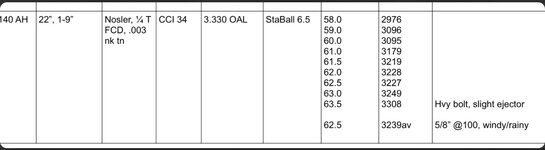

Update on my load development. I found a load for my 280 Ackley improved. It’s a savage 110. with a 22 inch barrel. With a 1:9 twist. The load I settled on was 58.5 grains of ram shot Hunter with a 160 grain nozzle Accu bomb. I’m using Winchester primers and nozzle brass. Also found I had to jump the bullet. 80k off the lands.
Thank you everyone for your suggestions and tips .
Nice shooting. You are almost there.
Try seating the bullets deeper to tighten up the group. Go .005" and .010". I'd bet one of those would do it for you.

I use staball 6.5 with the 140 grain absolute hammer bullet in my 280AI. It’s screaming along at 3200 from my 22”
That should work very well for you.
