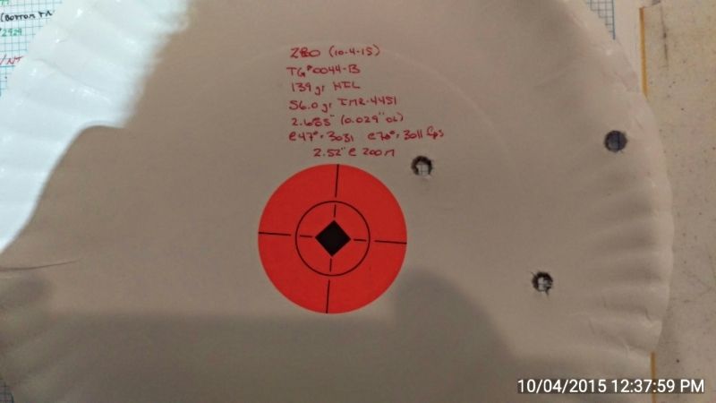

Ran some more test loads with the 280 this morning with 139 gr. Interlock-BT's & IMR-4451 / 55.5 gr., 56.0 gr., & 56.5 gr. The bullet was seated 0.029'' off the lands for all groups. It was a really nice morning...45* with almost no wind. None of the loads showed any signs of pressure.
A). 55.5 gr clocked at 2978 fps / 2.52'' vertical spread at 218 yds. (3 shot group)
B). 56.0 gr clocked at 3021 fps / 2.52'' triangle at 218 yds. *see pic* (3 shot group)
C). 56.5 gr clocked at 3040 fps / 2.72'' horizontal spread at 218 yds. (3 shot group)
I'm really happy with the velocities I'm seeing, but obviously I'd like to see some tighter groups. My thought is to take load B and play with the seating depth to see if things tighten up or adjust the powder charge 0.2 or 0.3 gr up & down and see if that improves things.
Do any of you guys see any potential with this load or do you think I'm wasting my time? Any thoughts or advice is welcome.
