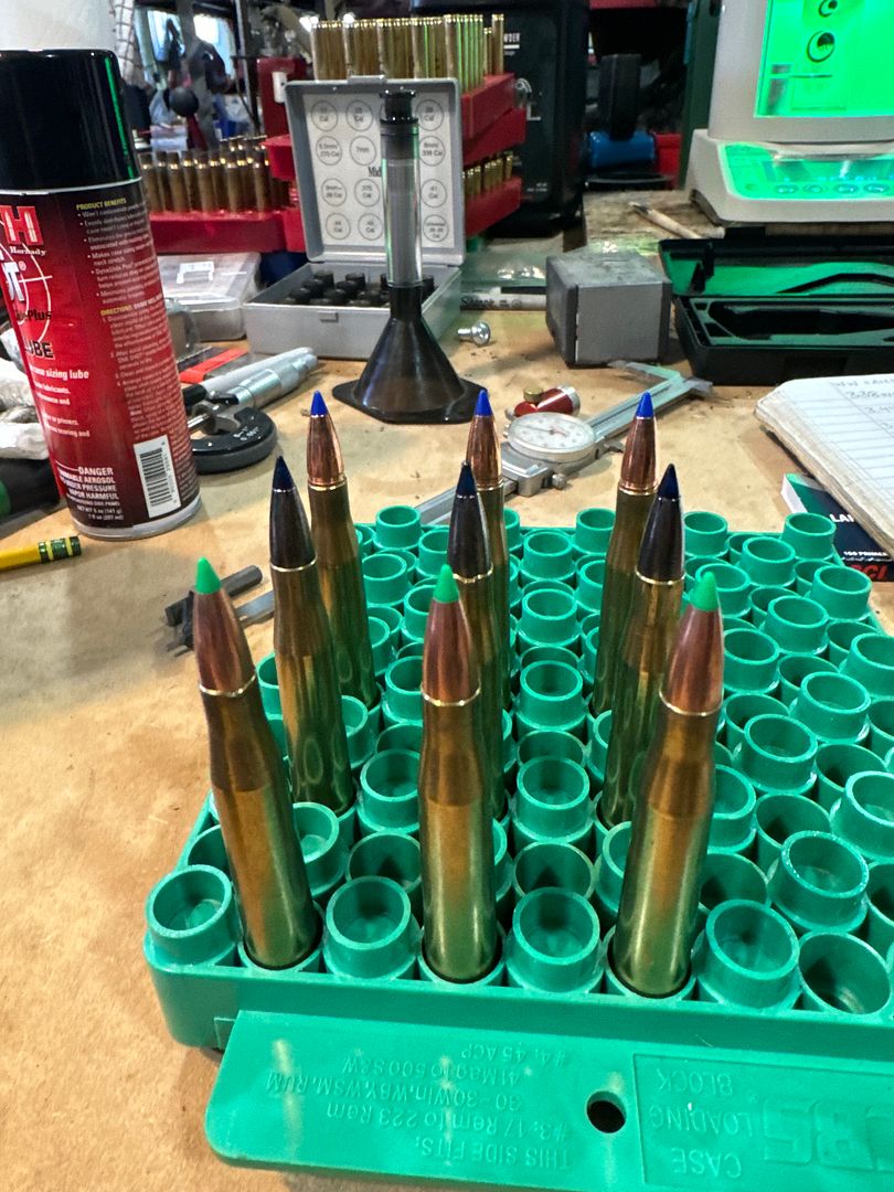

Doe anyone have experience loading 185gr vld or 180bt?
My other 30Nosler is a 9twist and have only shot 200gr and heavier bullets.
My new build is a 26" 10twist so I'm going for 195gr to 180gr bullets?
I'm loading Nosler brass if it matters.
Thanks.
180 Ballistic Tips and Accubonds shoots real good in my 300 Win Mag. I was googling for some 200 Accubonds to try out, Midway shows that its discontinued. I wondered why.
my othe 30 N load is Reloder25 with 200gr Hybrids.
I'm considering H1000, 7977, Rl25, rl26, maybe 7828, n656, n570 or Retumbo .
Maybe @DrMike could run quickload data?
30 nosler, 26 barrel
Case water capacity 101.4 gr water.
185 Berger vld hunting at 3.461"
185 Berger Hybrid target at 3.530"
185 Berger Juggernaut target at 3.480"
180 Nosler ballistic tip at 3.435".
Thanks in advance.
