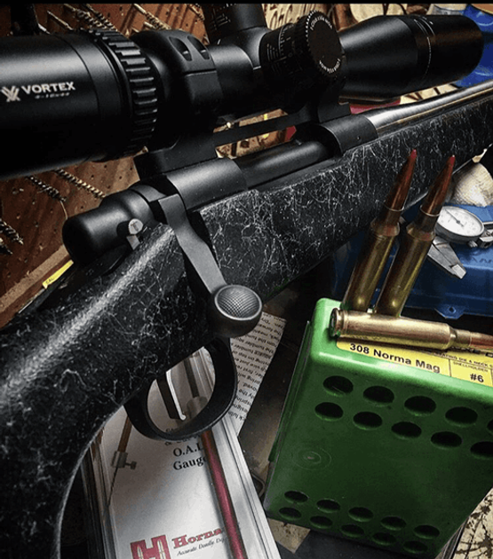

I have two 308 Norma Magnums.I shoot them with Norma brass,but it is softer at the base than Winchester and Remington brass I've made for it.I backed off my loads 1.5grs with the Norma brass I have to save my primer pockets.You can make brass three ways.Necking up 7mag brass,necking down 338 Win Mag brass down or running 300 Win Mag brass through the die.My opinion necking up 7mag is the best because it's the cheapest and easiest to find.338 Win Mag brass is sometimes harder to find since it's has a lower production and can cost more.300 Win Mag is the hardest because you have to totally push back and reform the shoulder a great amount,then also trim the very long neck that is formed because the brass was so much longer to start with.As for brass.Use brass that is new or once-fired.That brass is still soft and easy to form.After about the third or forth firing,the brass becomes harder and I anneal at that time.
There is not a lot of data for the 308 Norma Magnum.Probably because it's an older cartridge.Quick Load is your friend for adding newer powders.Dr Mike ran QL for me.It is really close if the QL is tailored to your barrel length,bullet type and weight and the max pressure.It's a great cartridge.Runs really close to the 300 Win Mag.Handloads probably exceed most factory 300 Win Mag loads.I had a 300 WSM with a 26" barrel.I found my 308 Norma Magnums with the same barrel lengths,easily achieved higher velocities.Really surprised the long range shooters haven't adopted this cartridge.The case length at 2.559 gives a lot of mag box room for seating bullets way out.

I used one for many years and still think it's the best of the belted magnums and compares well to many newer belt less rounds. I necked down 338 WM brass and it works fine with a bit shorter neck. That said Norma brass was awesome and would go that route.
I used MRP with 200's and the Nosler 220 Pt but that's impossible to find these days. With 180's IMR 4350 was a standout and that would be my first choice for almost any bullet you would want to shoot. Anything in that 4350 burn rate is a top choice for the round.
