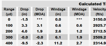

I haven't slain any great number of coyotes over the years. Some. Farthest was about 420 yards with my deer load from the 25-06, a 115 gr Nosler Ballistic Tip at 3150 fps. Zeroed the 6x scope (simple duplex crosshairs) at 300 yards.
I don't recall missing any coyotes with this setup, though I did refuse to shoot at a couple that just didn't give me a good shot opportunity. The one at 420 yards was heading uphill, away from me, and paused. I held on his nose and the bullet dropped right into his chest, dropping him on the spot. Simple setup, the flat trajectory did him in. Faster, flatter shooting loads would do even better at this. I like using my favorite deer rifle and load for coyote shooting. Keeps me familiar with things. In recent years I've branched out too much with too many different cartridges, scopes, rifles and loads. That's why I treasure my pair of Remigtons in 30-06 and 25-06 even more. I keep 'em set up just the way I like them in case I just need to grab a rifle and go shoot something.
