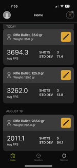

I have a minty 660 Remington in .222. I always loved these little rifles, and obviously Remington made very few .223's in either 660's or 600's and they are collectors today......So I thought I would try what .222 Factory ammunition I could find. (I have also considered re-chambering to .223 Rem, but I needed to know if I had a good barrel first). Found some Hornady Superformance and tried both 35 and 50 grain versions. The 35's Would NOT group. They were at best maybe 3" at 100 yards. SD's were the worst I have ever recorded at 71.4 FPS. Picture below of a 3 round group with the 50 grainers, and the snapshot of my Garmin Chrony showing the results of the 35 grain load three shot string. Obviously might just be my gun, but wanted you guys with .222's to see this.
