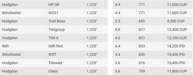

Well, Hodgdon doesn't list loads for Alliant powders. Bullseye just isn't there. Hodgdon doesn't have a business agreement with Alliant. However here are the lighter loads they show for a 45 ACP and a 200 gr LSWC bullet:
