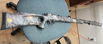

So it’s not a Traditions, but a Knight TK2000. I have attached some pics below.
Thanks for the tip on those “shot cards” WV, I will get some ordered.
I wonder if with the .715 roundballs, any sort of wad or patch is desirable?

I have never checked what caliber a 12 gauge barrel comes out as... .71 caliber sounds fun though! :D I feel like I remember people shooting with patched roundballs out of smoothbores but I don't remember anymore. I think it is hard to get great accuracy beyond 50-75 yards without rifling, but if you can get that close, a hunk of lead at .71 inches ought to knock down most things alive.

There is a ton of info on the Traditional Muzzle Loading Forum. As for shooting round balls thru a smooth bore most do use a patch you just try different thickness to see which combination gives best accuracy. If you plan on shooing round balls in this gun I would recommend not thru that full choke tube. See if you can find an Imp Cyl tube. The beauty of the smooth bore muzzle loader is it can be loaded with different combinations from shot, ball to buck and ball. Whole different ballgame.
