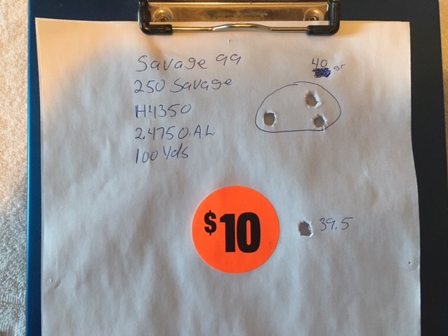

Borrowed some H4350 off a buddy, just enough to load up a few cases to see if it works for my 250 Savage. He has plenty of it but also uses IMR 4350 so we're gonna trade a lb for lb. Hodgdon shows a good bit more speed in this cartridge and bullet weight with H versus IMR.
Got a chance last evening to test it out. Worked pretty well but unfortunately it was towards dusk and the chrono wouldn't pick up any speeds. According to Hodgdon's data and subtracting for a 20" barrel, it should be right at 2800 or a little more, with the Speer 100 gr HC. Be about the right speed for that bullet if so. Will have to check again later.
Had 3 at the top loaded with 40 gr which is 1/2 gr below max. Not sure why the big jump up from 39.5 to 40 gr's. Must be a pressure and speed jump, but primers, cases, ejection was fine.
Measures 1 1/8". Scope is a 1.5-4.5 Bushnell. Trigger on this rifle is guessing 4.5-5 lb. In a lever gun I'll take it if it repeats.
The load is very promising. What a fine rifle for deer and other thin skinned game. Excellent post.
That's MOD right there! (minute of deer)

Hey Shade- I've been going back through some stuff and looking at my loads. How'd you manage to get 39.5 Gr of 4350 in that load let alone 40? Speers current Data on line shows 37.5 Grains as a compressed max load for that bullet. I get over pressure signs at 38 Grains some times with a 100 Gr BT. I am currently using two scales to verify charge weights just to tray and avoid stiff bolt lift, beat up cases and cratered primers. I ask because according to Quick load I've also been running my IMR 40604 load three grains over max (in the "dangerous" range for years. You didnt get any pressure signs with your load? I am confused. Do powders change that much over the years and pound to pound? BTW That is a beautiful rifle. That and your load and riflery skills make me officially jealous. Thanks for the thoughts. CL
I had to go look at what you're looking at, as this is an old post and not fresh in my head.
Couple of things as to how I was able to get 40 grains in the case.
A: I believe you're looking at IMR data and not H on the Speer data, you can get a little more in the case with Hodgdon. In the 250, as much as 1.5 grains more when showing compressed loads depending on what bullet and what source you look at.
B: If you don't just look at the generic Speer data under caliber, but click the 250 Savage specifically up at the top under cartridge selection, then the loads for a 100 grain bullet, you will see that the data they are giving is using the Speer 100 gr BTSP. That is a longer bullet than the 100 gr HC I'm using and cramps case capacity more than the hot cor in the little 250 case.
C: They are showing a loaded length for the 100 hot cor of 2.450. I'm loading at 2.475. Again, a little more case capacity allowance.
D: I don't have the 2 to compare, but they are using Winchester cases with the 100 grain hot cor. I'm using Hornady. Don't know if that is another addition to the other things or not since I can't compare, but I do know I can get 40 grains in easy enough and am not using a drop tube.
Hope that helped to clear a few things up. Sometimes data can be a bit confusing from 1 source to the next I know.
BTW Troy, as with most of my loads when I worked them up I did not have access to any computer generated load programs such as quickload, I still don't have quickload but do look at GRT different times.
I was curious since you brought this up so I checked out my data on GRT. Measured a couple of those 100 gr HC's and showed an average length of .940. Using that and my loaded length of 2.475, 40 gr's of H4350 is at the very top but still under peak allowed pressure. It shows a load ratio of 96.3% so not yet quite compressed, which is what I found.
If you have an older rifle I'd work up and maybe stay down at 39 or so with H4350 just to be safe if you haven't shown any issues before reaching that charge.
Thanks for the extra leg work Shade. That all sorta makes sense. However it does sorta confirm the perception I am working on that this is not the "exact science" some would have us believe. For example, just the variables between H and IMR leave us with some variables that the average reloader cant account for . No piezo electric measurement equipment for re-loaders. Seems to me that means that "middle of the road" data is the only reasonable place to start, and that will only be good for one pound of powder, one set of cases, etc. Again impressed with your load. Thanks for the thoughts. CL
