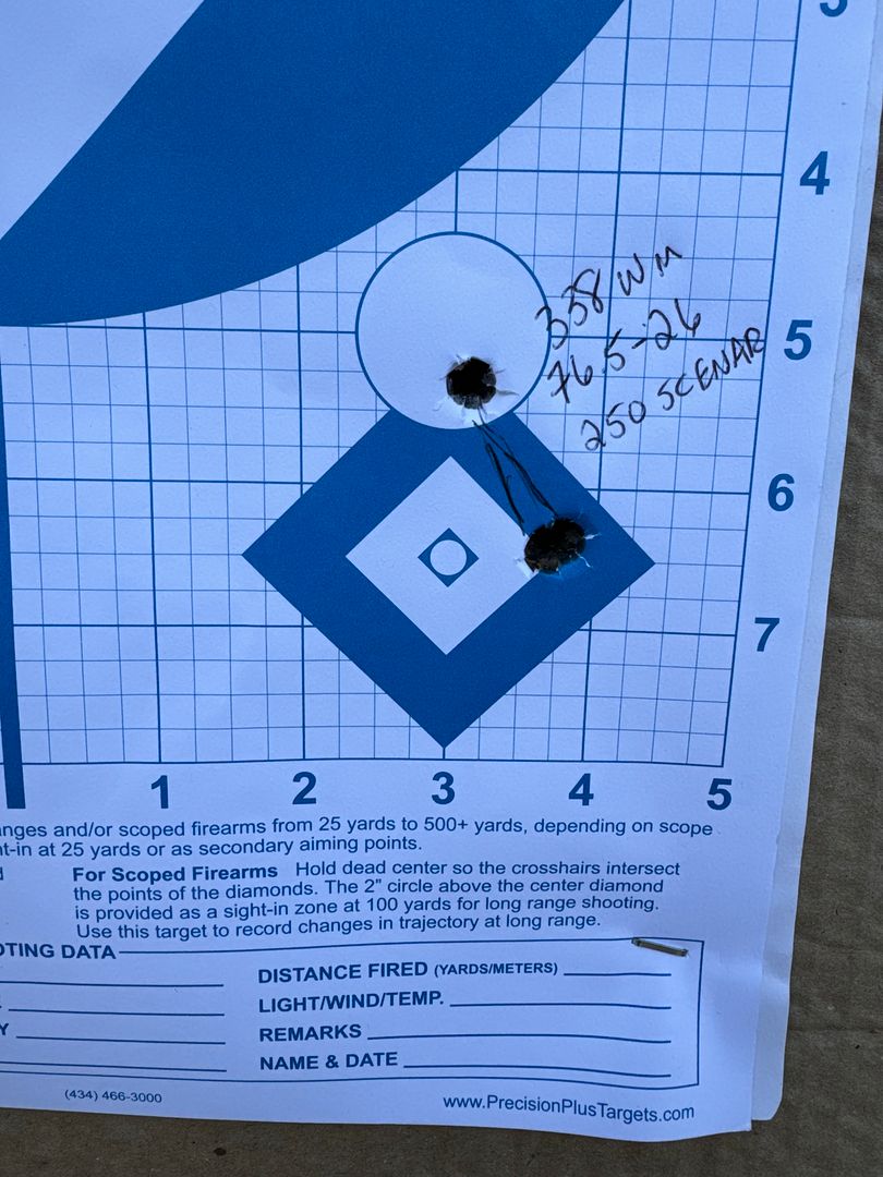

I don't have any pictures of the lower charges, but as I crept up and the speed started coming around here is what I got.

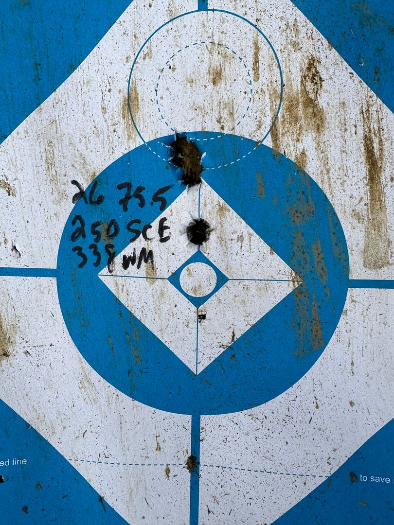

75.5 was starting to look decent though.

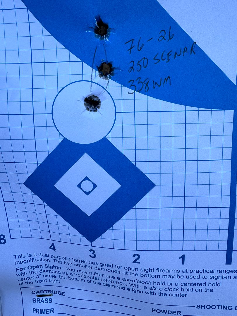

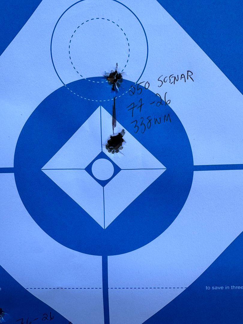

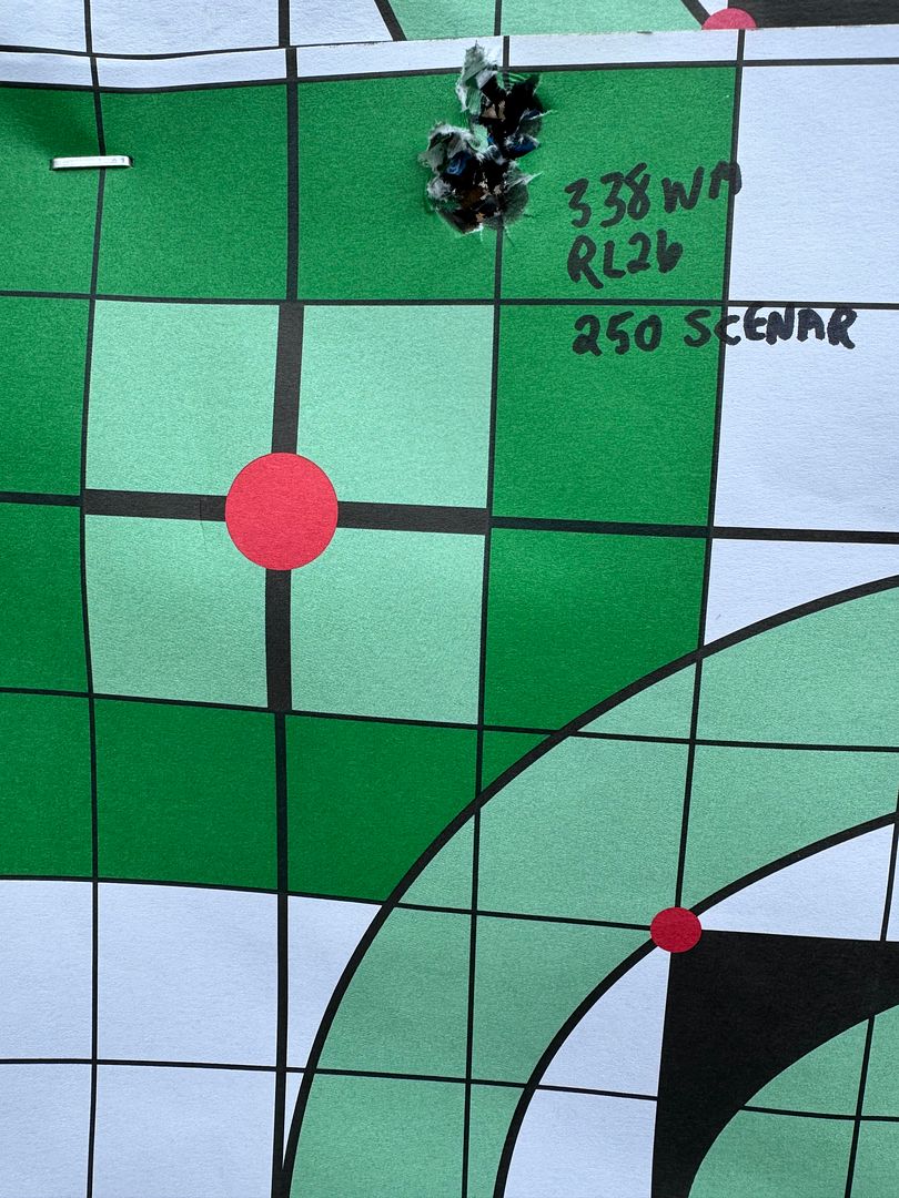

76 grains
76.5

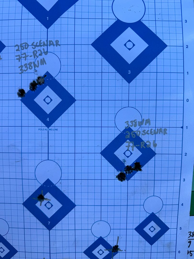

77

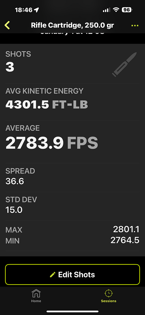

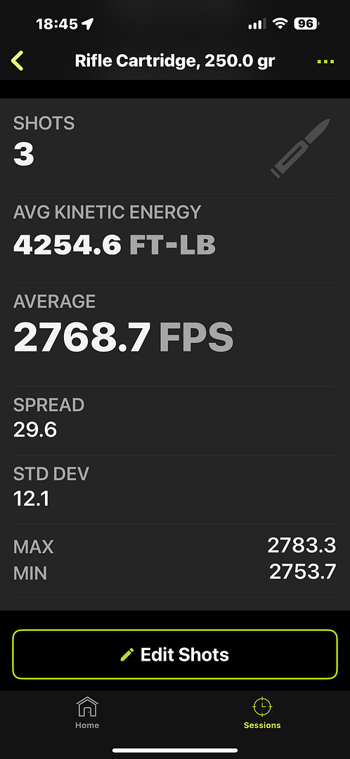

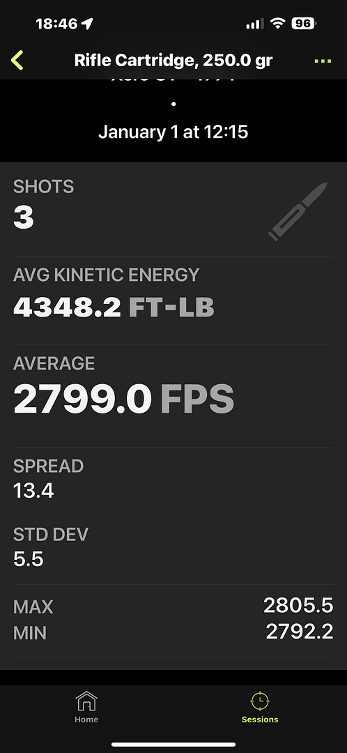

I was pretty impressed overall with the way it shot. It's been a good while since I have done load work with my old Alaskan, but it seems to still wanna shoot. Kept putting the 3rd round out. I shortened the next batch I loaded .010" and will reshoot with 77 grains to see where I am at. I am at 2800 even with that charge which is more than plenty for what I am doing.

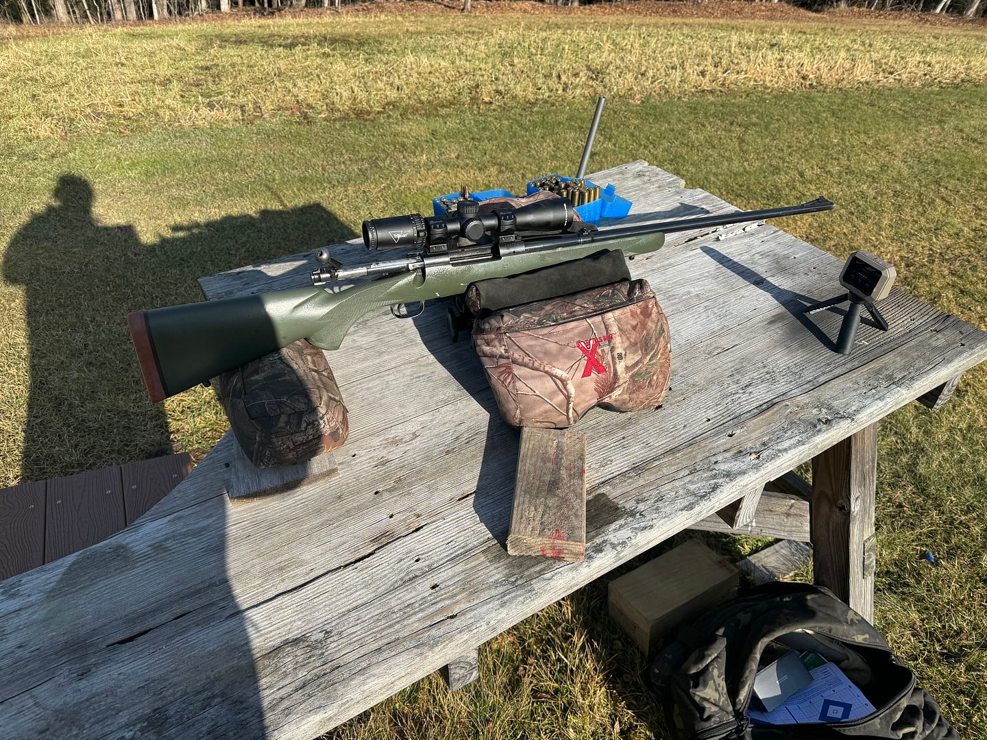

Took the old trusty 338 out the other day as soon as the cold front moved in. It was about 17 degrees that day, but still as could be on the range.
Pretty happy with the old Alaskan. It is nice to have another load for the books in this rifle. I ordered up some Hammers to try out of it, but if they don't come around quick, I will load up the Scenars and give them a whirl this year.

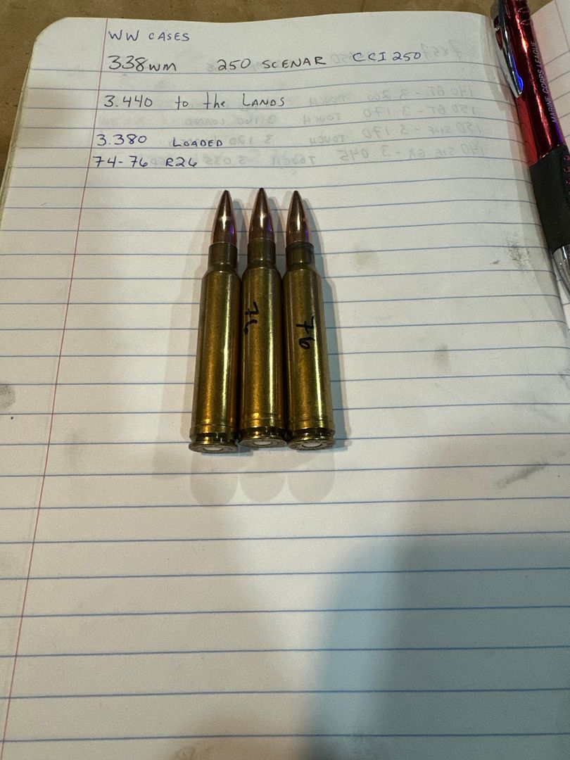

3.370" COAL was what has been shooting. Might be able to go another .010" shorter, but I wanna stretch it out some before I change anything. Shooting at distance will give me a better idea if anything needs to be changed I think.
