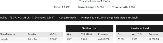

Should I be concerned though that the upper end of the ReTumbo charge is nearly 5 grains more than the load you reference? I don’t have pressure signs, but I do know with good brass it may be over pressure and not show it. The last thing I want is to be unsafe. If I didn’t say it above, I am using ADG brass.
Here is the load data from Hodgon for Retumbo. I am not a huge fan of running over book on powder charges, but velocity usually will tell more about pressure (in addition to ejector marks, primer flattening/craters, etc.) Please note the 67.5 to 68 grains of powder I use is for H1000 power only.
Yeah. That’s what has me worried. I don’t see any signs on the brass and didn’t have any hard bolt lifts, but 3 grains over is a lot. I love that top end speed, but I may need to test the ReTumbo/71.20 load and H1000/68.50 and go from there.
