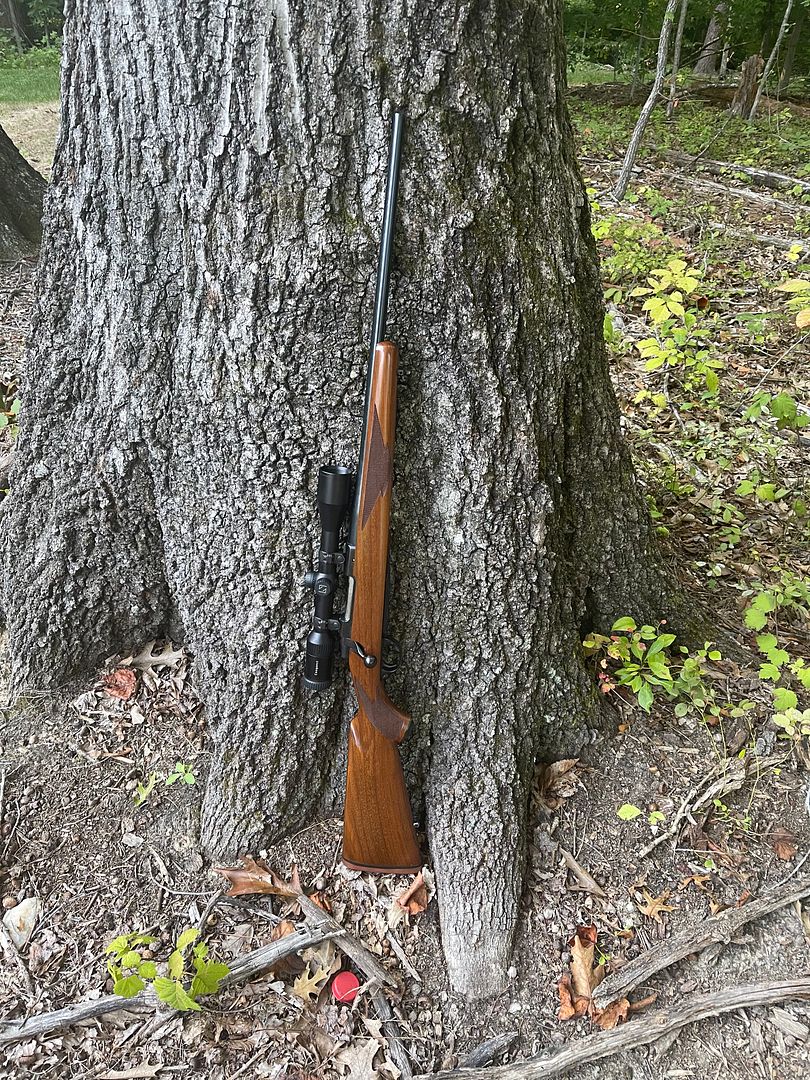

I have a 1976 Ruger 77 250 Savage. I haven't gotten around to really ringing it out but I had some good results with Ramshot Hunter and 115 BT's. I ran my data using QL and reformed Lapua 22-250 cases. Worked like a champ.

Now I feel bad I haven't really done much with the old rifle. Need to break it out and get it warm again.
What a sweetheart cartridge that is highly efficient. That info Scotty posted is pretty impressive. 2950 in a 22" barrel with a 100 gr bullet and only 37.5 gr's of powder while still at a mild for modern rifle pressure of under 54,000 psi.
I don't shoot or use mine near as much as I should either. Guess I'm saving for when I'm old and can't take shoulder pounding anymore. Ha.
And the 250 Savage keeps on performing!
Looking forward to getting my rebarreled Model 88 (22" Benchmark barrel) home and then working up loads for it and the Ruger 77 RSI (18.1/2" barrel). I have a good supply of 100 and 115 gr BTs and 110 gr ABs to try. Looks like I will have to pick up some Big Game and Hunter powder.
Beautiful rifle, and those numbers w/ Ram Shot big game and a 100 gr BT are certainly interesting! Other numbers quoted are great as well. Such a nice cartridge. Please post your results! CL
