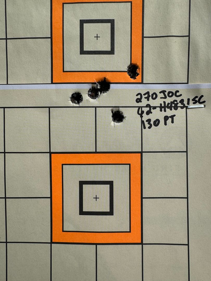

That’s pretty interesting. I’ve been working with H4831SC quite a bit in my current 270 with 130 Speer HCs and Nosler PTs. Speeds fine at 3120’ish for both but getting knot hole sorta groups has been evading me. Sitting around 1.25” or so for 5 so I may try some IMR4831 instead.
It’s a little faster than H4831 but it’s better suited to the 270’s case capacity than H4831SC in my opinion. I also love the 130gr Hot Cor. Great bullet. RL23 is a great option too if you have any.
Thanks Joe. I have both of those. I’m going to try one more range session with H4831SC then I’ll back up and regroup. As it sits now, it’s not horrible but I think it could be a touch better.
I always get caught up chasing groups myself. Out of my own vanity I guess. I forget sometimes that even with a 2” group, that bullet is going to impact within 1” of where my crosshairs were when the shot cracked at 100 yards.
