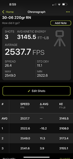

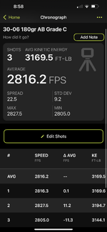

This afternoon being too wet to do anything else , I dug out the 30-06. I decided to try out the 220gr RN bullets I got and some 180gr AB Grade C. Input my data into QL for some baseline with N555 and went from there. My Winchester brass is a little large on internal capacity making N555 ideal to work with.
Both top charges do have a slight swipe. The velocity on the 180gr AB was more than I was expecting. These 2 will go on the list for accuracy testing on my summer vacation. I will focus on 2600fps with the 220s and 2850fps with the 180s.

The Grade C 180gr AB shot somewhat decent. I did a second group to see if the AB didn’t like following the Hornadys. Both are about the same size.
Those 220's sure do shoot!
What kind of speed are you getting from your 30-06 220 gr load?

I can get the 180 NAB leaving a 22" barrel at ~2850 fps with several powders.
I have run the Hornady 180 gr. SP at a little over 2800 FPS from two Remington M700s, a BDL and a Classic.. Accuracy was OK (1.5") but could stand improvement.
