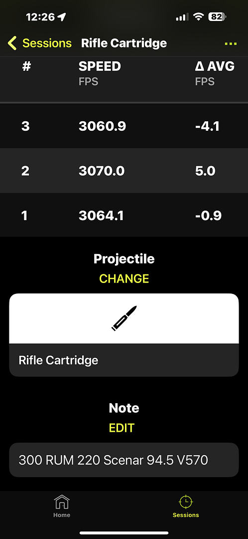

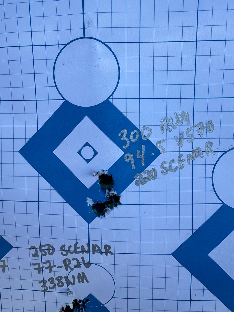

I decided a couple weeks ago of trying to see if I could get the 210 ABLR's to shoot in my RUM. Well, I tried all of the good powders I have on the shelf, 570, RL33, H1000, Retumbo and SB HD. I worked up in speed to get a usable load and tried 4 each of each specific powder charge. To my anger, NOTHING, not a darned one began to shoot.
I won't even bother posting pictures, but picture an improved cylinder 410 at 50 yards with 000 buck.. It was bad..
Anyhow, I was scratching my head thinking maybe something was broke or the scope was bad. On a whim, I loaded up a known load that has shot well in the past and tried it out.
Needless to say, I put the ABLR's back on the shelf till I have a barrel that can stomach em :cool:
Well, that is a load that will work on about anything you'd ever wish to hunt in NA. (y)
Nicely done. The only ABLR I EVER got to shoot was the 129 from my 264 Ruger #1. That is it!
Seat them a tad deeper
